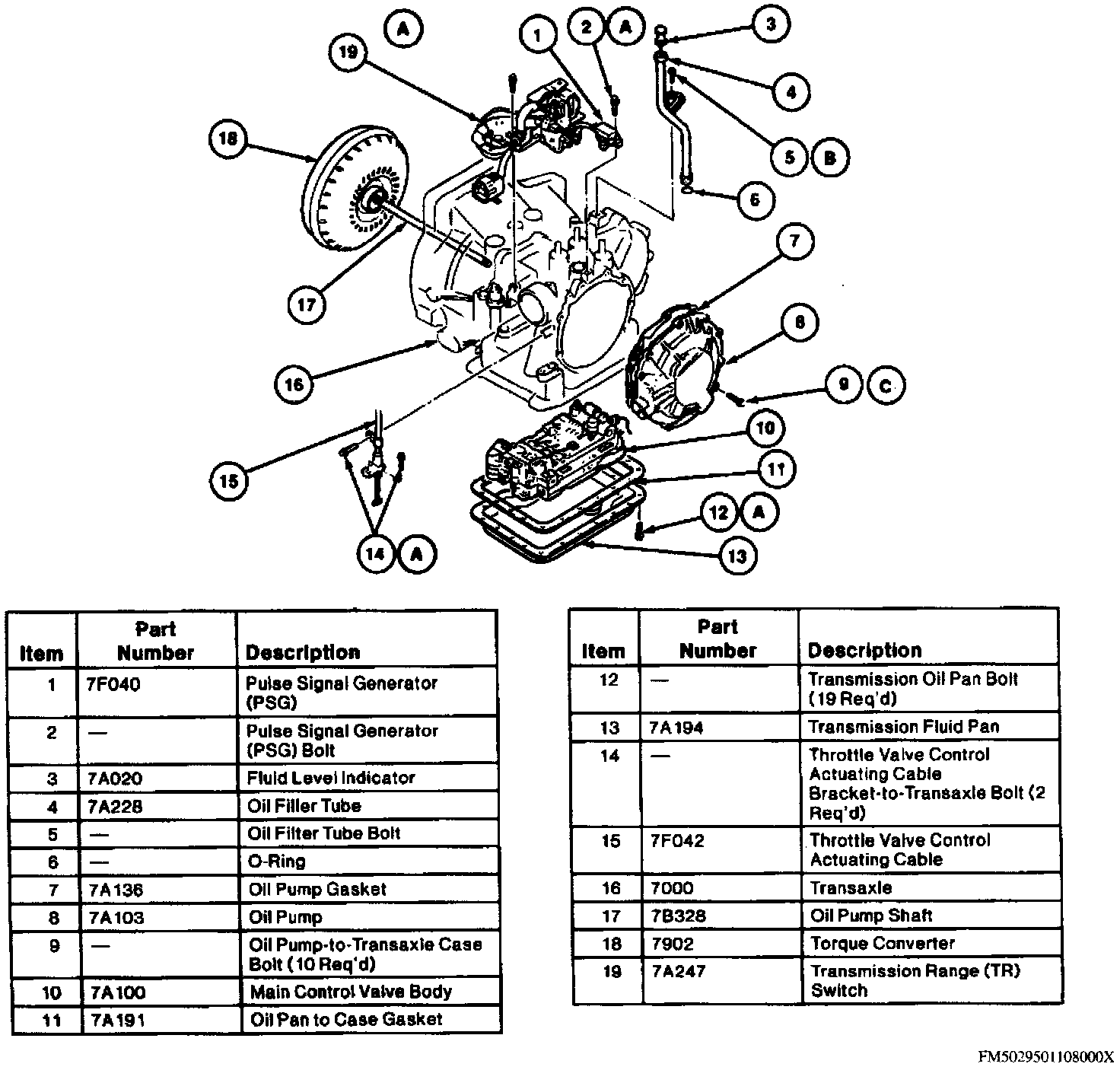

Transaxle External Components, (Capri, Escort, And Tracer):

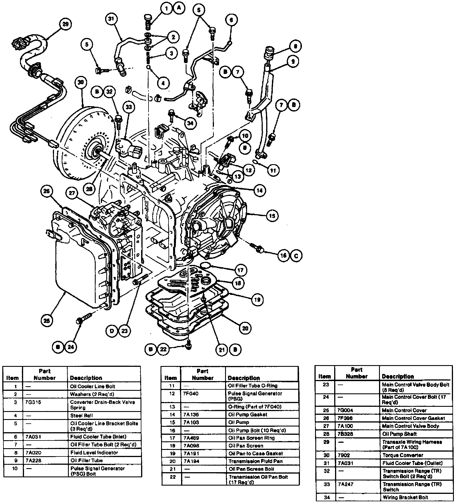

Transaxle External Components, (Probe):
5. Remove pulse generator, fluid temperature switch, and neutral safety or manual lever position switch, as shown in the Transaxle External Components images.
6. Remove back-up lamp switch, then disconnect solenoid connectors and harness.
7. Remove transaxle vent hose then the oil pipes, oil hoses, and switch box as an assembly.
8. Remove spring and steel ball using pencil magnet.

9. Remove oil pan and gasket.
10. Remove oil strainer and 0-ring, then the control valve body cover and gasket.
11. Remove throttle cable attaching bolt and bracket, then the cable from throttle cam of valve body.
12. Pinch teeth of solenoid connector and remove it by pushing inward.
13. Remove Transaxle Oil Temperature (TOT) sensor, then remove electrical connector from transaxle case. Discard 0-ring.
14. Remove control valve body and oil pump as an assembly.
