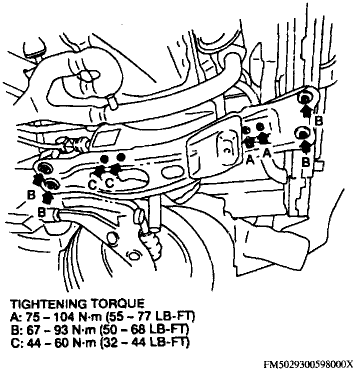

Tightening Transaxle Cradle Nuts And Bolts:
14. Install transaxle cradle. Torque cradle bolts (A) to 55-77 ft lbs, (B) to 50-68 ft lbs, and (C) to 32-44 ft lbs.
