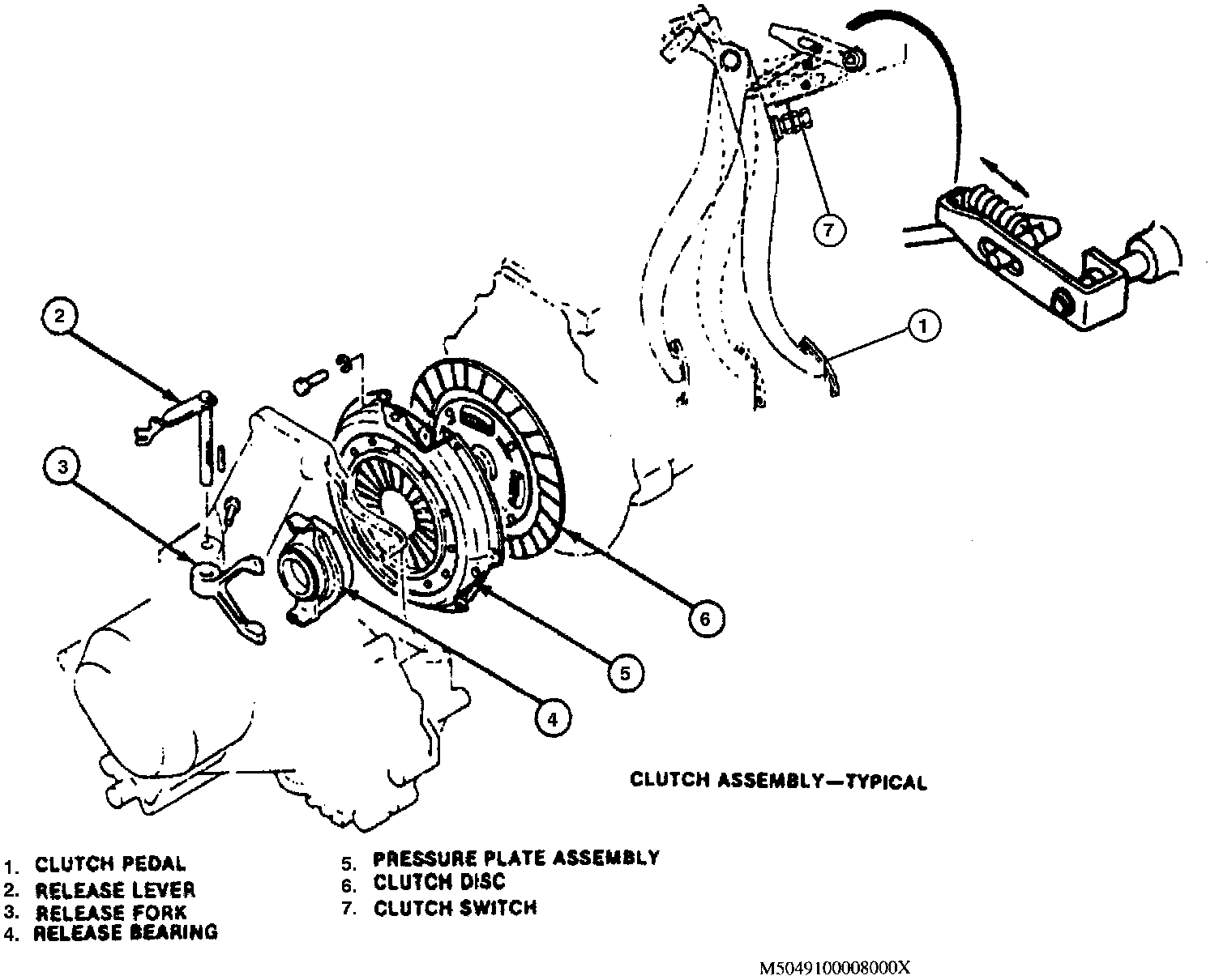

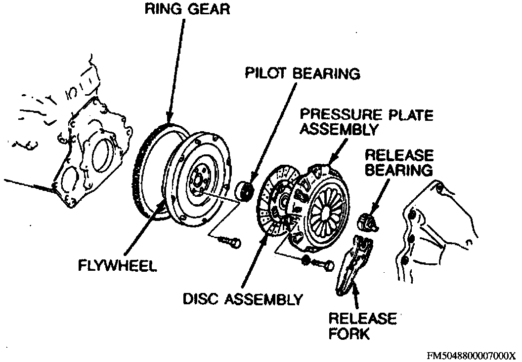

Clutch Assembly (Probe):
Clutch Assembly (Capri):
5. On all models, remove bolts attaching pressure plate assembly to flywheel and the pressure plate assembly.
6. Remove clutch disc and the clutch aligning tool.
