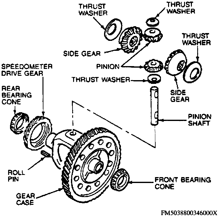

DISASSEMBLEExploded View Of Differential:
NOTE: Refer to the Exploded View Of Differential when performing the following procedure.
1. Remove roll pin, then the pinion shaft.
2. Remove pinions and thrust washers by rotating them out of gear case.
3. Remove side gears and thrust washers.
4. Remove the bearing cone from the speedometer drive gear end using gear and pulley puller tool No. D80L-630-3 and bearing puller attachment tool No. D84L-1123-A, or equivalents, with legs from puller set tool No. D80L-927-A, or equivalent.
5. Remove speedometer drive gear, then the bearing cone from ring gear end using puller tool No. T77F-4220-B1 and step plate tool No. D80L-630-3, or equivalents.
ASSEMBLE
NOTE: Whenever bearing cone is removed, it must be replaced.
1. Install speedometer drive gear and bearing cone using driver handle tool No. T80T-4000-W, or equivalent, and differential bearing cone replacer tool No. T88C-77000-EH, or equivalent.
2. Install bearing cone on ring gear end using driver handle tool No. T80T-4000-W and differential bearing cone replacer tool No. T88C-77000-EH, or equivalents.
3. Install washers, pinions, and pinion shaft.
4. Install lock pin, then crimp it to ensure it will not come out of case.
5. Install thrust washers and side gears.
