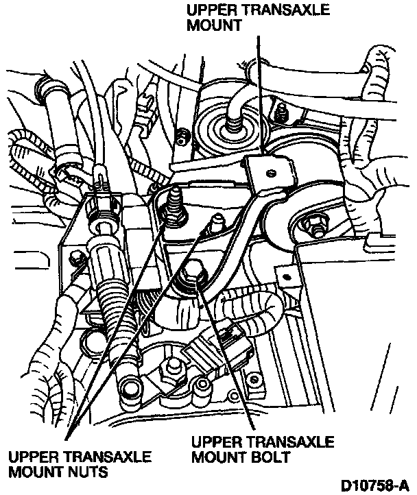

2. Remove the air cleaner assembly.
3. Remove the two upper transaxle mount nuts and bolt.
4. Remove the upper transaxle mount through bolt.
NOTE: It is not necessary to disconnect the fuel lines from the fuel filter.
5. Remove the fuel filter bracket bolts from the LH transaxle mount. Position the fuel filter and bracket aside.
6. Remove the upper transaxle mount.

5. Install the upper transaxle mount.
6. Install the two upper transaxle mount nuts and bolt.
7. Tighten the transaxle mount nuts and bolt to 67-93 N-m (50-68 lb-ft).
8. Install the upper transaxle mount through bolt.
9. Tighten the upper transaxle mount through bolt to 86-116 N-m (63-86 lb-ft).
10. Install the fuel filter and bracket on the upper transaxle mount.
