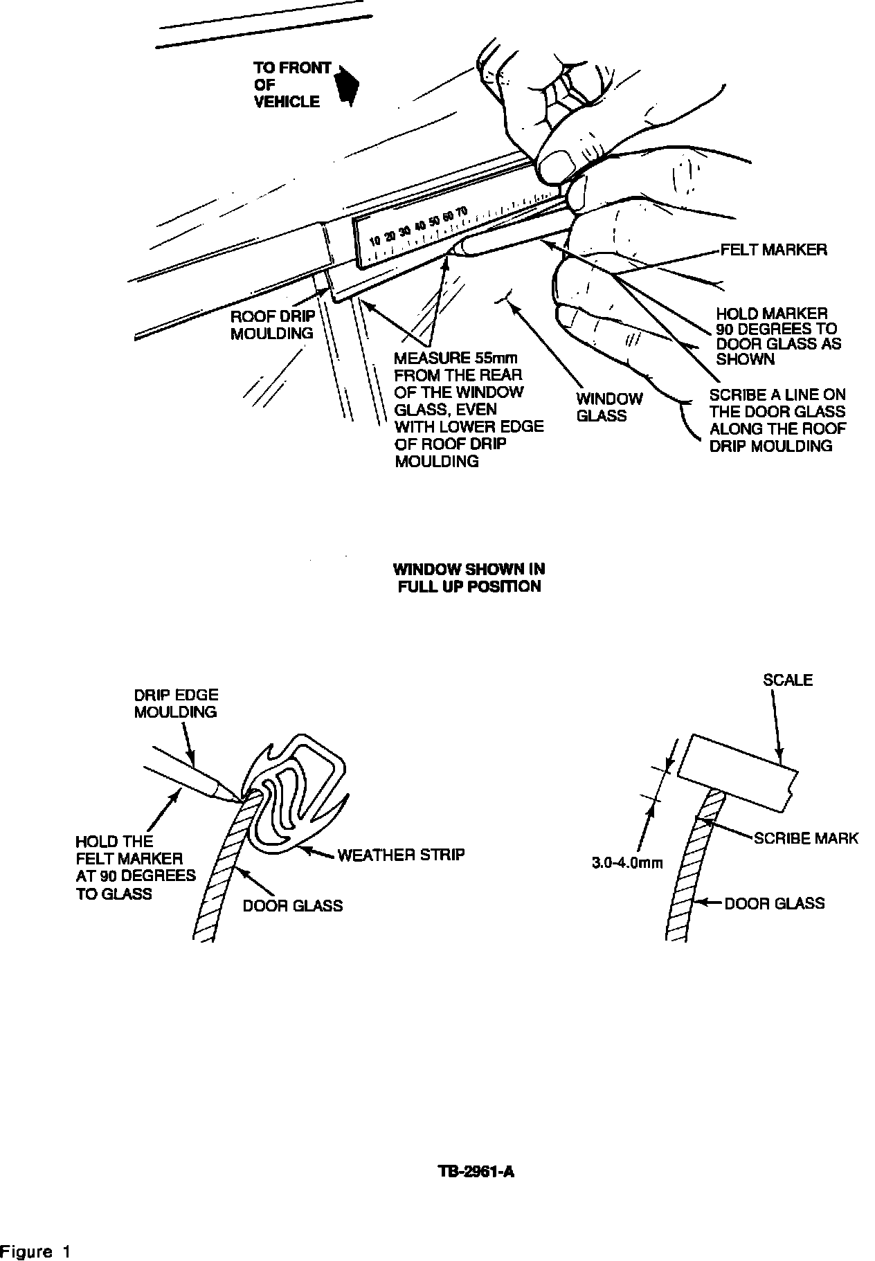

a. With the window in the full up position and the door closed, draw a line along the top of the glass with a felt marker. Locate the line 55 mm from the rear of the glass even with the lower edge of the roof drip moulding, Figure 1. The mark must be 3-4 mm from the top edge of the glass.

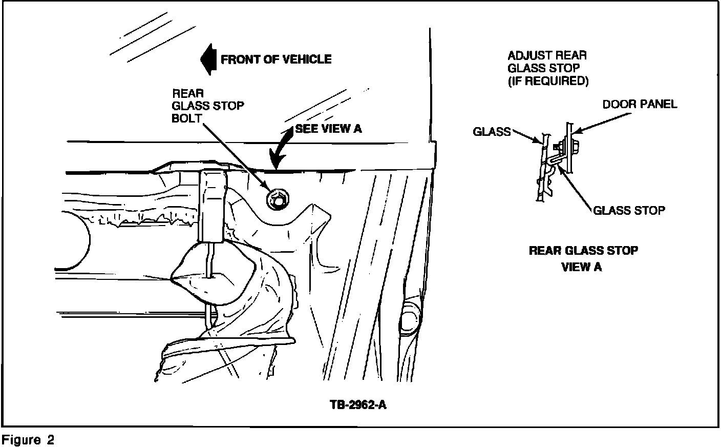

b. If adjustment is required, lower the window 1" (25.4 mm) and move the rear glass stop, Figure 2.
c. Loosen the glass stop bolt just enough to be able to slide the stop and move the stop the same distance the mark is out of specification. Example: If the glass is 1.0 mm too high, lower the stop 1.0 mm.
d. Tighten the glass stop bolt.
e. Raise the window and recheck.

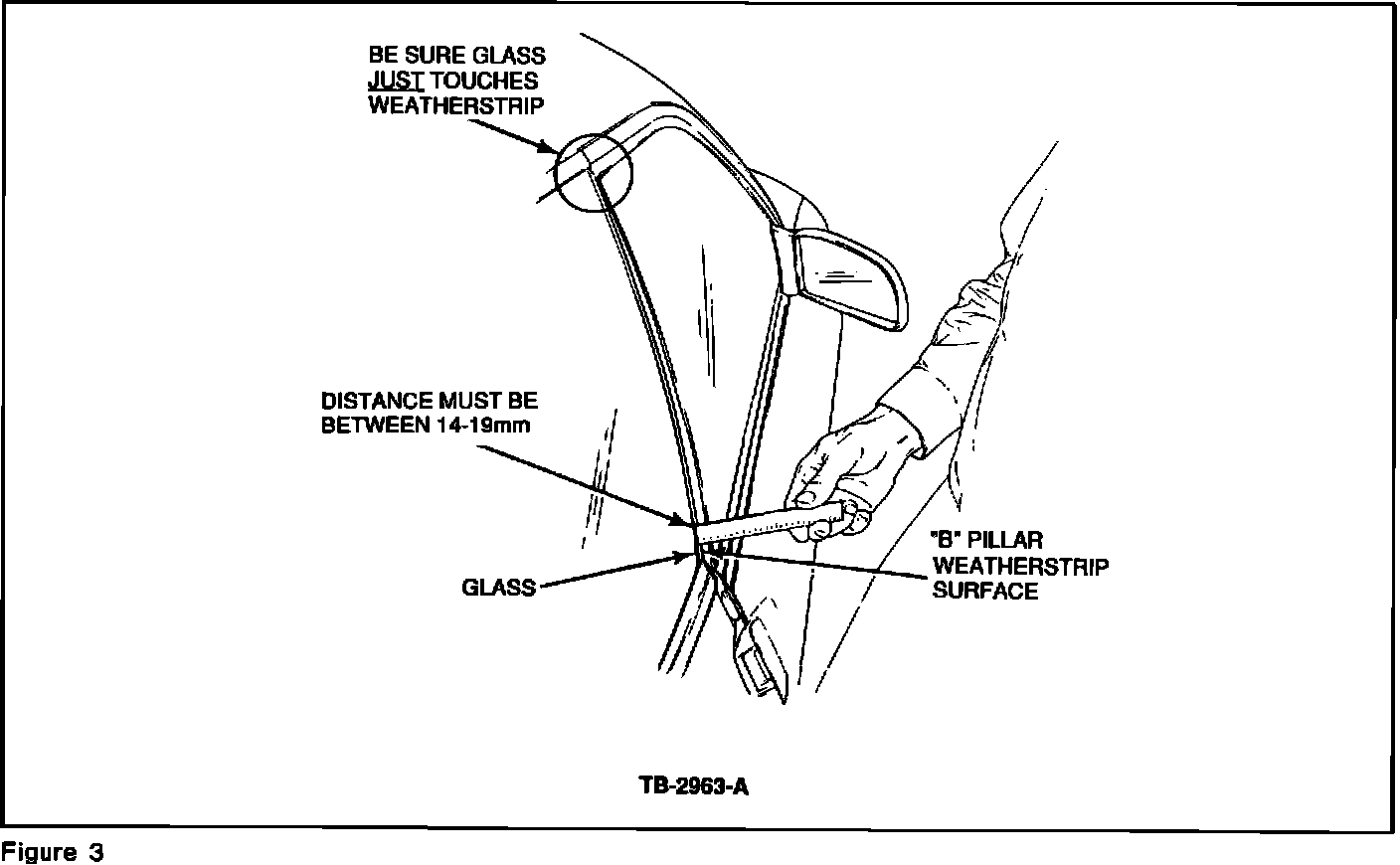

a. With the glass in the full up position, close the door until the top rear corner of the glass lightly touches the weather strip.
b. Measure the distance between the "B" pillar weatherstrip surface and the outside of the glass. See Figure 3. This distance must be between 14-19 mm.

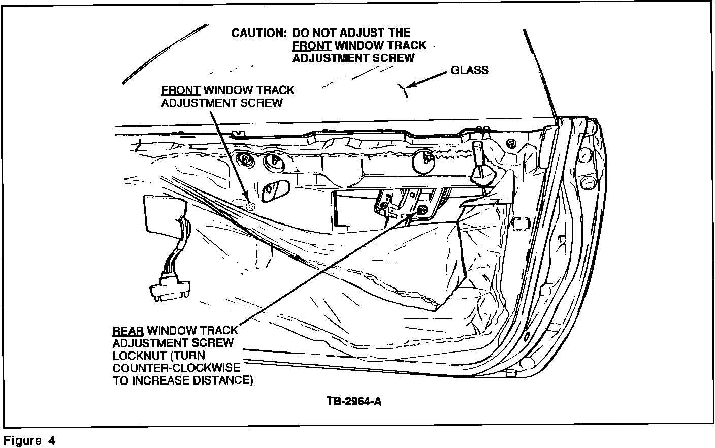

c. To adjust, loosen the adjustment screw locknut, Figure 4, and turn the adjustment screw counter-clockwise to increase the distance.
d. Tighten the adjustment screw locknut.
e. Recheck the distance between the "B" pillar weather strip surface and the outside of the glass. See Figure 3.

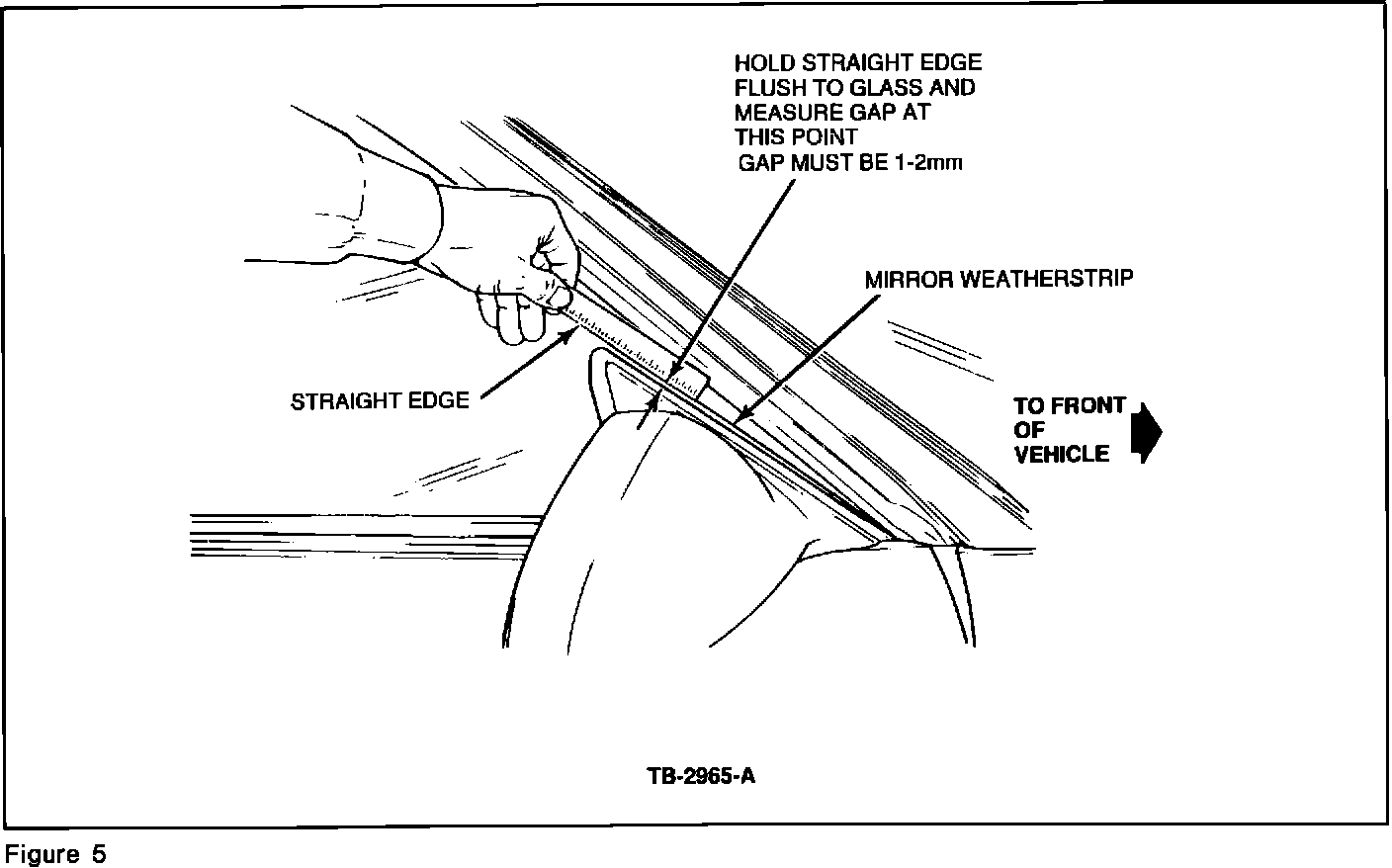

a. With the glass in the full up position, place a straight edge on the glass. See Figures 5 and 7.
b. Measure the gap between the straight edge and the top of the mirror weather strip. The gap must be 1-2 mm.
c. If adjustment is required, lower the window 1" (25.4 mm). Loosen the front glass stop bolt, Figure 2, and move the stop the distance required to obtain the 1-2 mm gap as shown in Figures 5 and 7.
