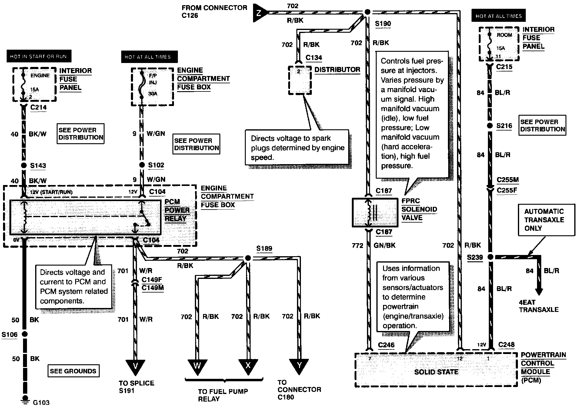

Electronic Engine Control (Part 1 Of 8):
FEEDBACK PRESSURE REGULATOR CONTROL SOLENOID VALVE
PCM POWER RELAY

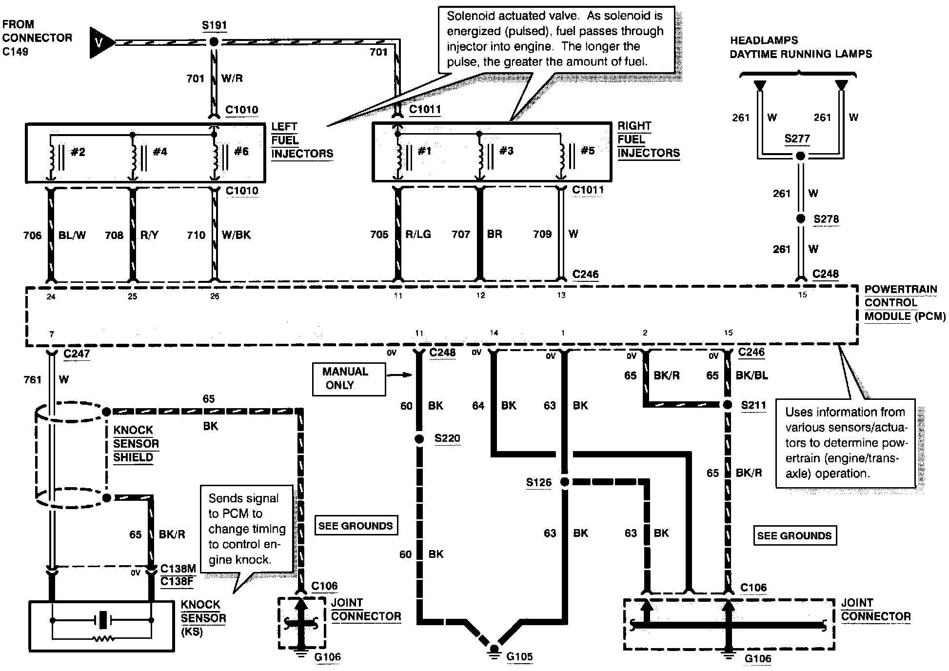

Electronic Engine Control (Part 2 Of 8):
KNOCK SENSOR
LEFT FUEL INJECTORS
RIGHT FUEL INJECTORS
