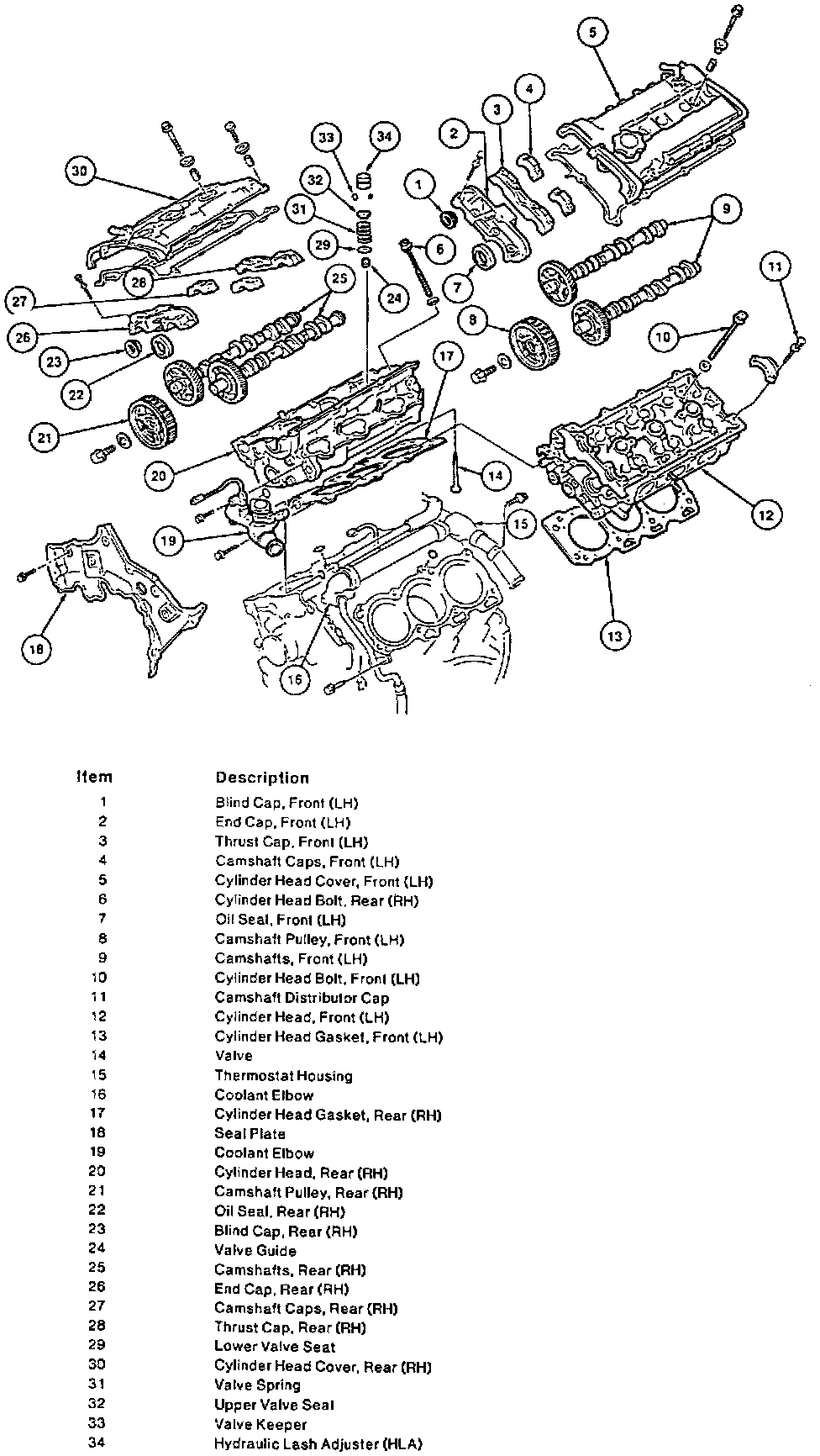

Camshafts Replacement:
REMOVAL
1. Remove intake manifold.
2. Remove cylinder head valve covers.
3. Remove timing belt.
4. Remove camshaft pulley lock bolts, then the pulleys.

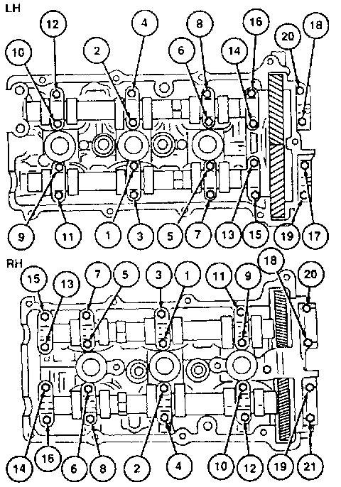

Removing Front Camshaft Cap Bolts:
6. Camshaft caps are identified on righthand bank (rear) by numbers and on lefthand bank (front) by letters. Loosen lefthand (front) camshaft cap bolts in five or six steps in sequence as shown.
Removing Inside Camshaft Cap Bolts:
7. After removing left (front) camshaft caps, remove remaining camshaft cap bolts in sequence shown.
8. Remove camshaft caps and camshafts, then the oil seals from camshafts.

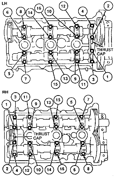

4. Install thrust caps and tighten bolts until they are fully seated against cylinder head.
Camshaft Cap Bolt Tightening Sequence:
5. Install remaining camshaft caps, noting the following:
a. Right (rear) bank caps are numbered and left (front) are lettered.
b. Torque camshaft cap bolts to 8-10 ft lb in five equal steps, following sequence.
