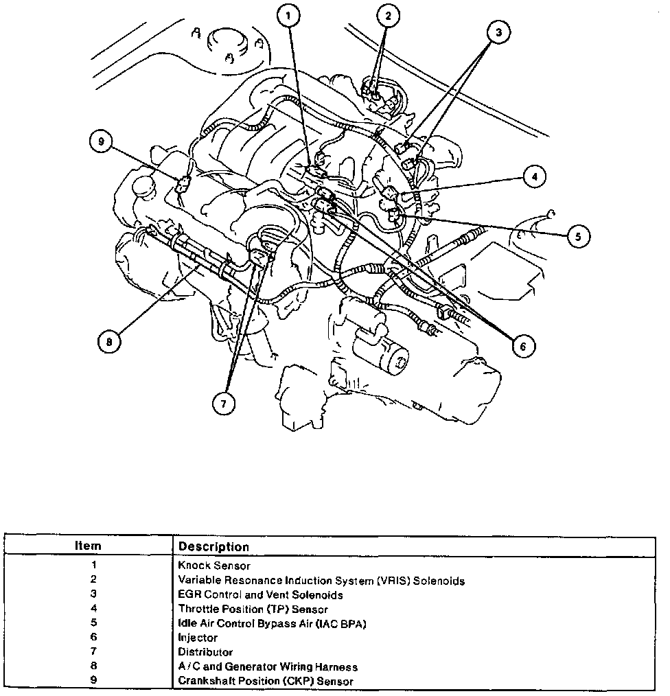

Engine Electrical Connectors:
27. Disconnect engine electrical and vacuum connections. Label for installation reference.
