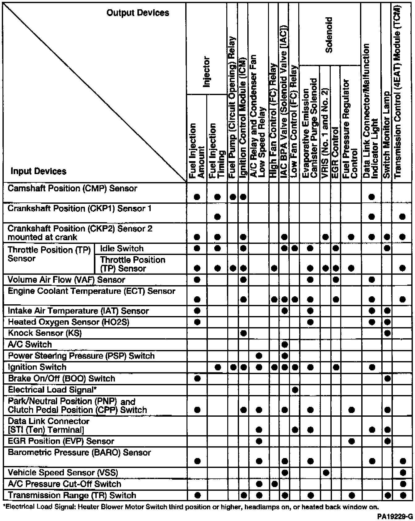

Relation Of Inputs And Outputs:
INPUTS/OUTPUTS
Individual components function as either input or output devices.
Input devices modify or generate voltage signals that the Powertrain Control Module (PCM) "reads".
Output devices are PCM operated or controlled components.
Not all of these devices are monitored by the on-board diagnostic system. Some input signals come from devices that are not specifically PCM sensor devices.
For example, the A/C amplifier signals the PCM when the air conditioning is turned "ON", for idle speed control (to compensate for the additional load on the engine). In the case of many output devices (relays and solenoids), the PCM output function is simply to make or break the ground circuit to turn a device "ON" or "OFF".
