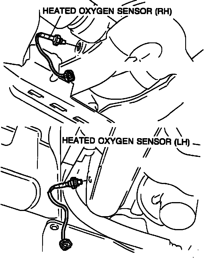

Oxygen Sensor: Description and Operation
Heated Oxygen Sensors:
Oxygen Sensor Operation:
