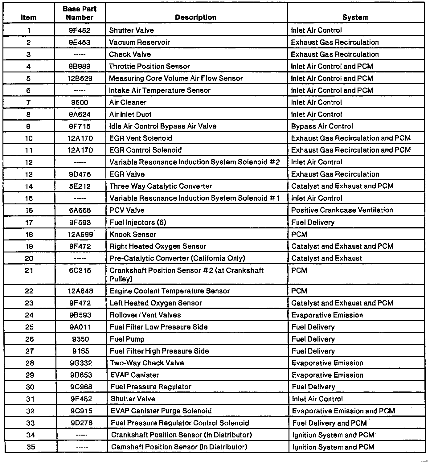

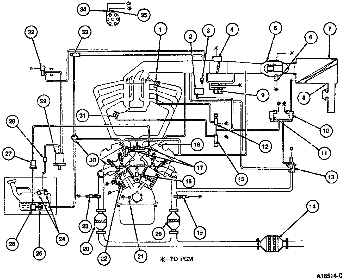

Emission Related Systems:
Component Identification:
