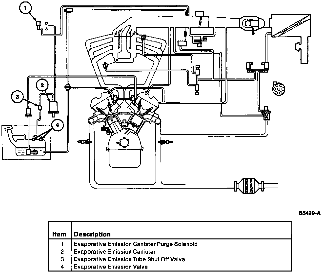

Evaporative Emissions Components:

Evaporative Emission Control System
Fuel is stored in the EVAP canister until it is drawn into the intake manifold and burned when the engine is started. The system is controlled by the Powertrain Control Module (PCM), which operates the Evaporative Emission Canister Purge Valve based on various signals.

System consists of a charcoal canister, canister purge solenoid, rollover/vent valve, two-way check valve and a vapor separator.
