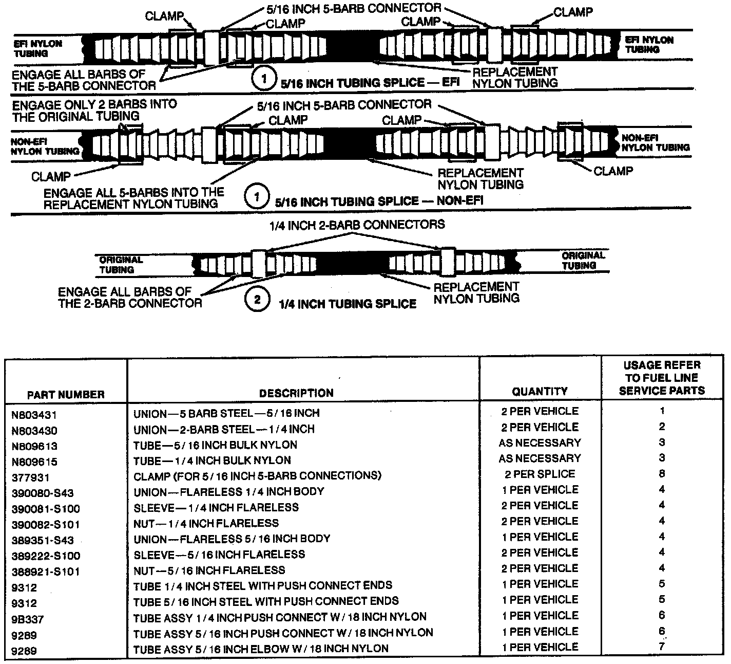

4. Select the proper (1/4 or 5/16-inch) barbed connectors for completing the splice. Two connectors are required for each splice.
5. Install the barbed connectors into each end of the replacement tubing using boiling water.
6. Install clips onto any tubes which might be difficult to access once the final splices are completed.
7. Install four keystone clamps loosely onto the original nylon tubing before beginning Step 8.
8. Complete the splice of the replacement nylon to the original nylon tubing at both ends. Refer to the illustration.
9. Tighten the clamps in the locations shown in the illustration.
