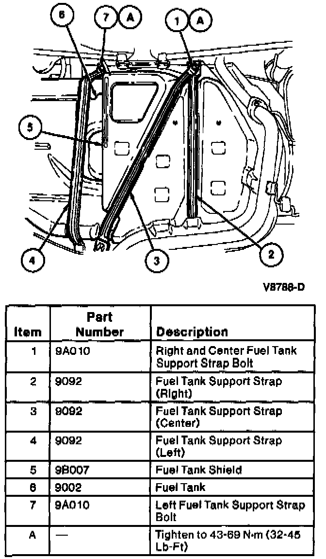

Fuel Tank Straps:
CAUTION: Do not apply excessive force to the bottom of fuel tank with the jack. This could bend the fuel pump bracket inside the fuel tank.
11. Support the fuel tank and remove the right and center fuel tank support strap bolt.
Shield:
12. Remove the fuel tank shield.
13. Remove the left side fuel tank support strap bolt.
WARNING: When removing the fuel tank, keep sparks, cigarettes, and open flames away from the fuel area.
Fuel Tank:
14. Remove the fuel tank.
