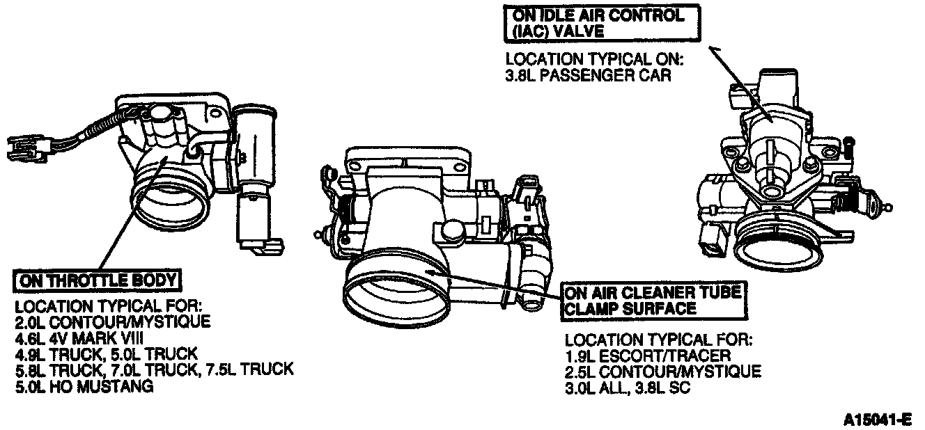

Throttle Body Assembly Decal Location:
Throttle bodies with sludge tolerant design are identified with a yellow/black decal. The throttle body must not be cleaned inside the bore, as this cleaning will impair the sensitive coating. Sludge accumulation will not affect the idle air flow. The cleaning procedure for the IAC valve still applies.
