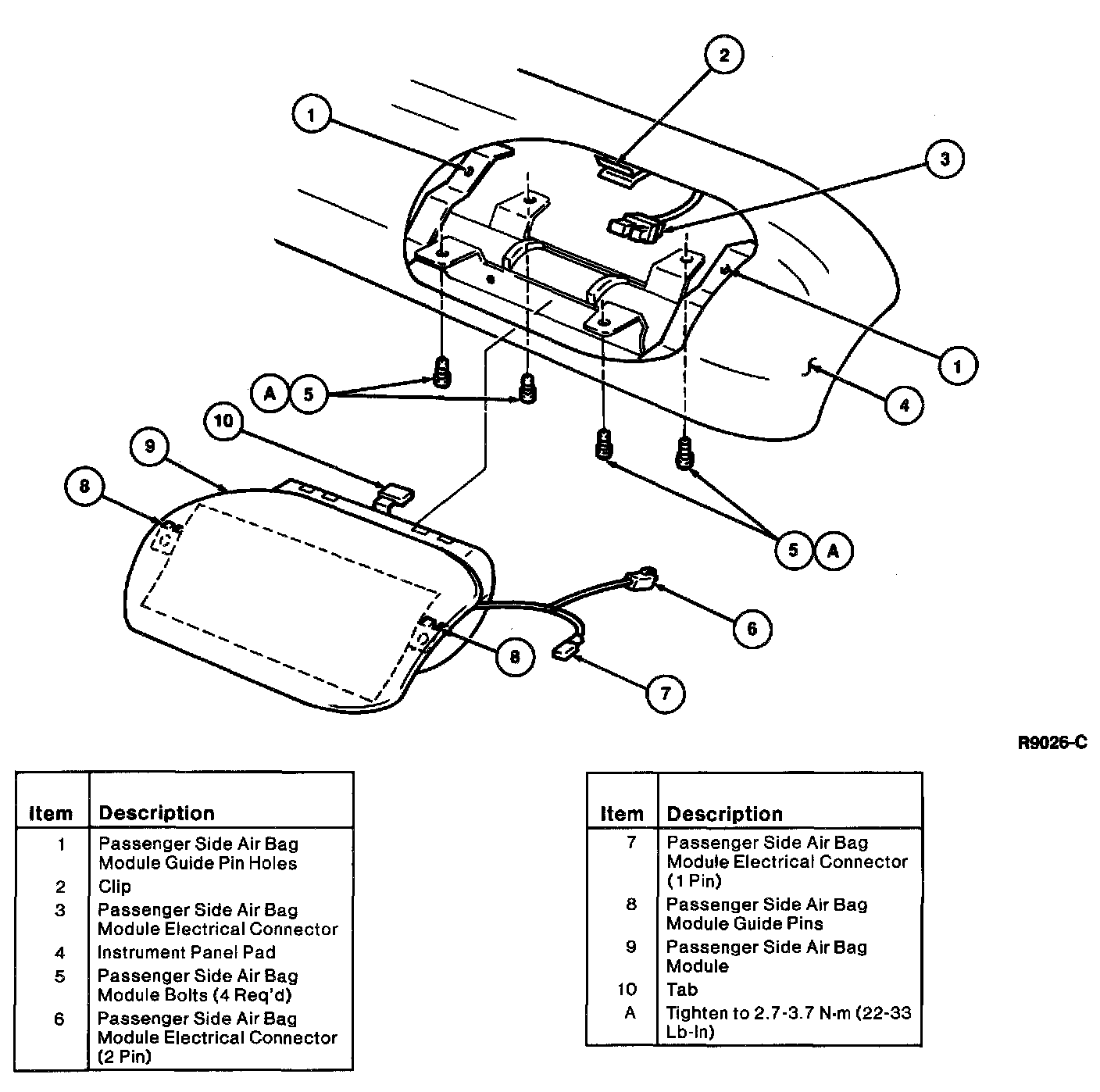

7. Disconnect the passenger side air bag module electrical connectors
8. Remove the four bolts passenger side air bag module bolts.
9. Remove the passenger side air bag module by pushing on the passenger side air bag module from inside the instrument panel. Do not handle the passenger side air bag module by the edges of the trim cover.

1. Insert the passenger side air bag module into the instrument panel, making certain the guide pins insert into the guide holes. The tab on the passenger side air bag module must insert into the clip in the instrument panel.
2. Secure the passenger side air bag module with the four passenger side air bag module bolts removed during the removal procedure. Tighten the passenger side air bag module bolts to 2.7-3.7 Nm (23-33 lb-in).
NOTE: Make certain the wiring harness is not pinched between the passenger side air bag module and the instrument panel pad.
3. Connect the passenger side air bag module electrical connectors.
NOTE: Connect all connectors securely.
4. Insert the pin on the connector into the hole on the back of the passenger side air bag module.
