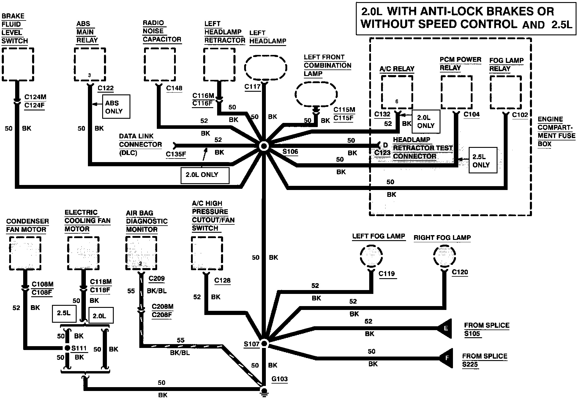

Ground Diagrams (By Component Name)
Grounds (G103):
A/C High Pressure Cutout/Fan Switch
A/C Relay
ABS Main Relay
Air Bag Diagnostic Monitor
Brake Fluid Level Switch
Condenser Fan Motor
Electric Cooling Fan Motor
Fog Lamp Relay
Headlamp Retractor Test Connector
Left Fog Lamp
Left Front Combination Lamp
Left Headlamp
Left Headlamp Retractor
PCM Power Relay
Radio Noise Capacitor
Right Fog Lamp
