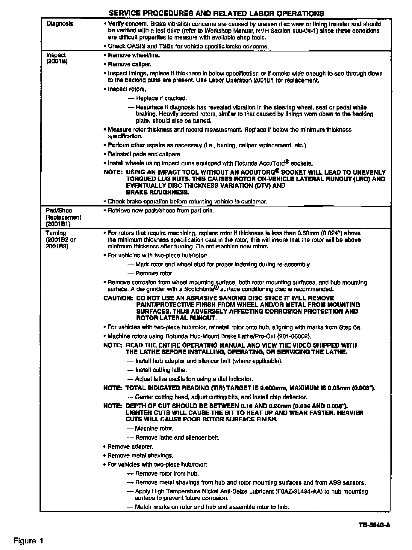

Several service procedures relating to brake vibration, system inspection, and pad/shoe replacement have been revised. Detailed descriptions of the service procedures are shown in Figure 1.
Please note the changes for turning brake rotors. Criteria for sufficient rotor thickness before turning has been added to reduce the number of rotors that are replaced or turned to a dimension below the minimum thickness specification.
Final Lateral Runout (LRO) and disc thickness measurements have also been deleted since proper rotor measurement and machine adjustment will insure that these dimensions are within specification.

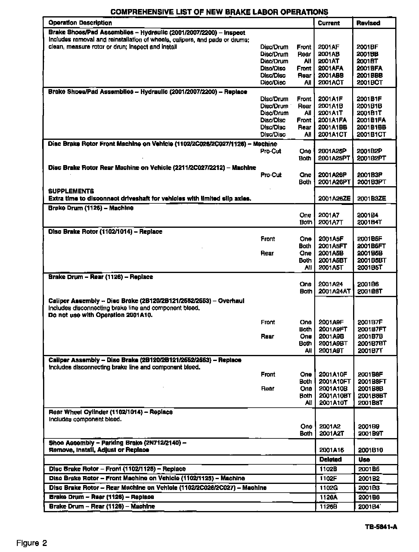

As part of this change, all car and light truck repairs will now be sequenced under labor operation 2001B, labor operation 2001A will remain in effect for medium and heavy duty truck applications. A unique labor operation for brake pad/shoe replacement, 2001B1, was added along with a consolidation of all turning operations into two labor operations, 2001B2xx and 2001B3xx. A comprehensive list of brake labor operations are listed in Figure 2. These new codes will be in the October Service Labor Time Standards release.
