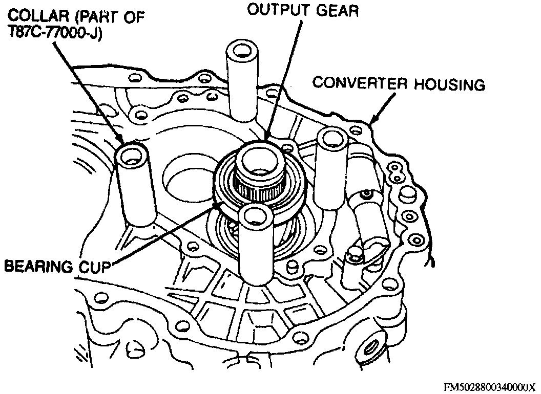

a. Position bearing/stator support using valve body guide pins tool No. T80L-77100-A or equivalent, then press support into converter using step plate adapter tool No. D80L-630-6 or equivalent.
b. Remove bearing cup and adjustment shim(s) from bearing housing, then place bearing cup over output gear bearing.
Collars On Converter Housing Installation:
c. Place four collars, part of shim selection set tool No. T870-77000-J or equivalent, on converter housing.
Shim Selection Gauge On Output Gear:

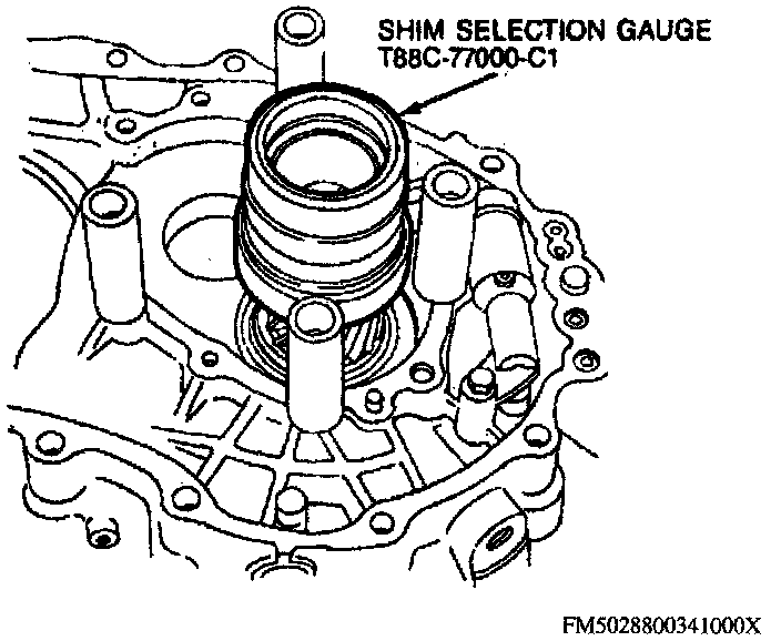

d. Place shim selector gauge tool No. T880-77000-C1 or equivalent, on output gear. Turn both halves of selector to eliminate any gap between them.

f. Place shim selection gauge tool No. T880-77000-C1, or equivalent, on output gear. Turn both halves of selector to eliminate any gap between them.

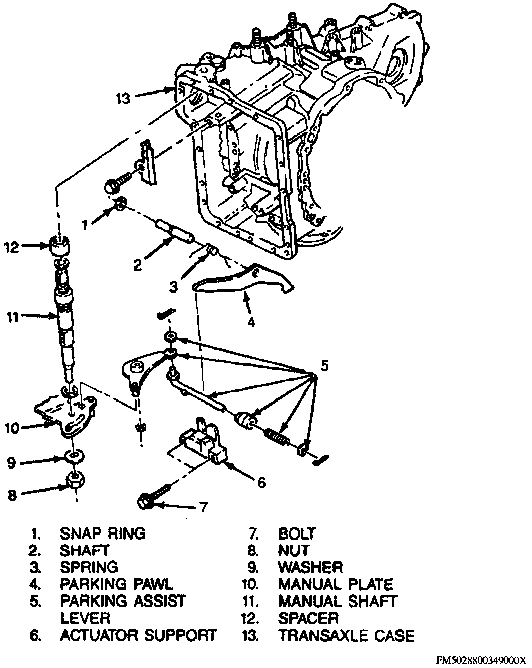

8. On 1992-1994 models, install differential.
9. On all models, install parking pawl and shaft, then the spring and snap ring.
10. Move manual shaft and check operation of parking pawl.
11. Install parking assist lever and snap ring, then the actuator. Torque actuator mounting bolts.
Manual Shaft Components Installation:
12. Install manual plate, spacer, washer and nut. Torque manual shaft nut.
13. Install manual shaft bracket. Torque bracket bolt.
14. Install detent ball, spring, washer, and plug. Torque plug.
