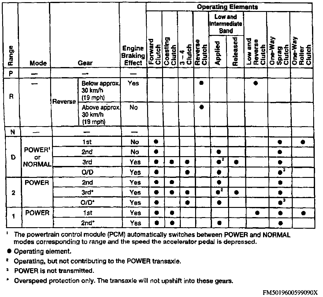

DESCRIPTIONAutomatic Transaxle Operating Characteristics:
This test is an evaluation of the automatic transaxle performance. The test should only be conducted when the 4EAT Symptom Chart directs you here. The Road Test involves a driving evaluation of the transaxle shifting quality, ability, and timing. Shift problems will be directed to a list of symptoms for appropriate actions to take. These symptom charts are given: Upshift, Downshift, and Shift Feel for various symptoms encountered.
