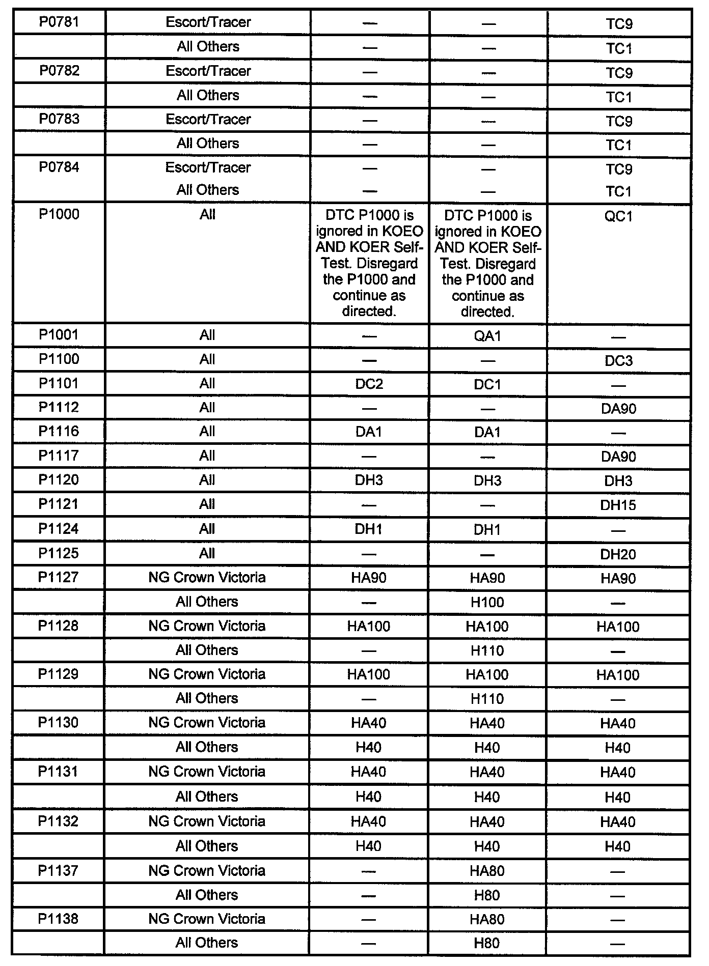

Note 1: DTC P1000 is ignored in KOEO AND KOER Self-Test. Disregard the P1OOO and continue as directed.

P0781 - P1138
P01150 - P1390

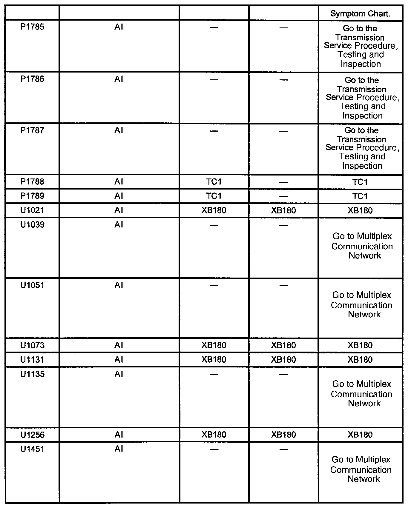

P1785 - P1769, U1021 - U1451
