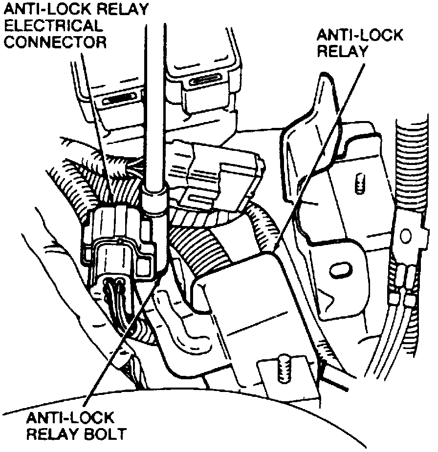

Fig. 25 ABS Relay Replacement:
1.
Remove ABS relay bolt.
2.
Disconnect relay electrical connector, then remove relay.
3.
Reverse procedure to install.
