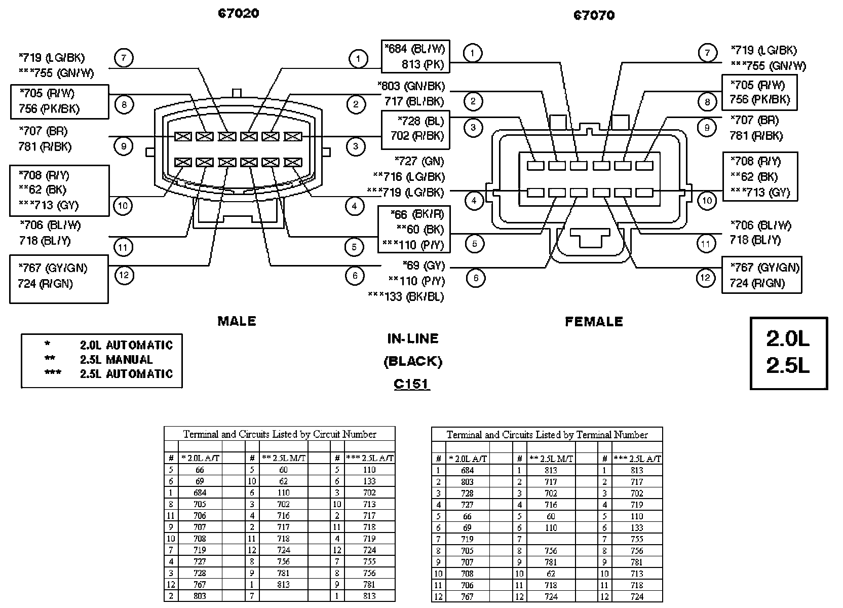

C151:
The automatic transaxle equipped vehicle shows an inline connector C151.

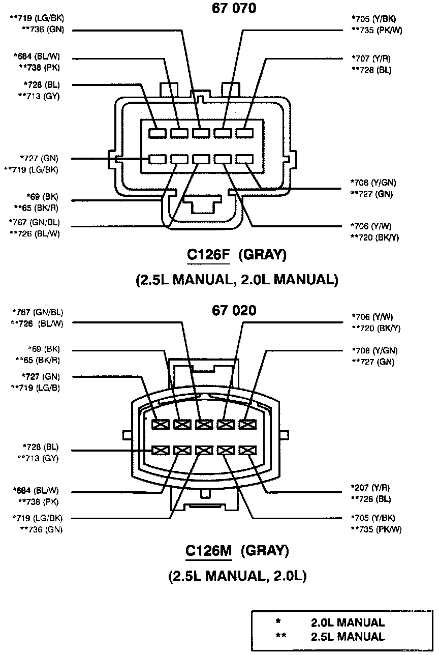

In-Line Connector Faces - C126:
The manual transaxle equipped vehicle shows an inline connector C126.
