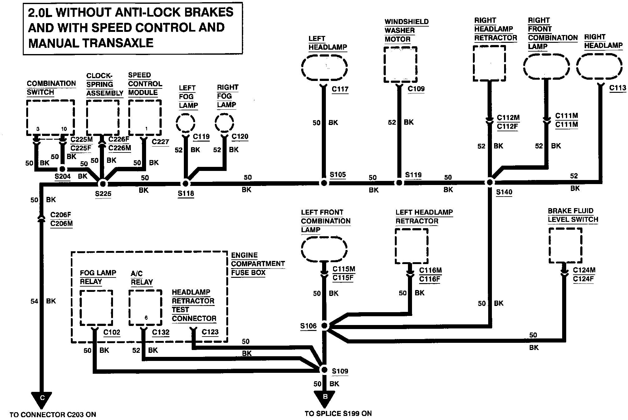

Grounds (G103 & G203):
A/C Relay
Brake Fluid Level Switch
Clockspring Assembly
Combination Switch
Engine Compartment Fuse Box
Fog Lamp Relay
Left Fog Lamp
Left Front Combination Lamp
Left Headlamp
Left Headlamp Retractor
Right Fog Lamp
Right Front Combination Lamp
Right Headlamp
Right Headlamp Retractor
Speed Control Module
Windshield Washer Motor

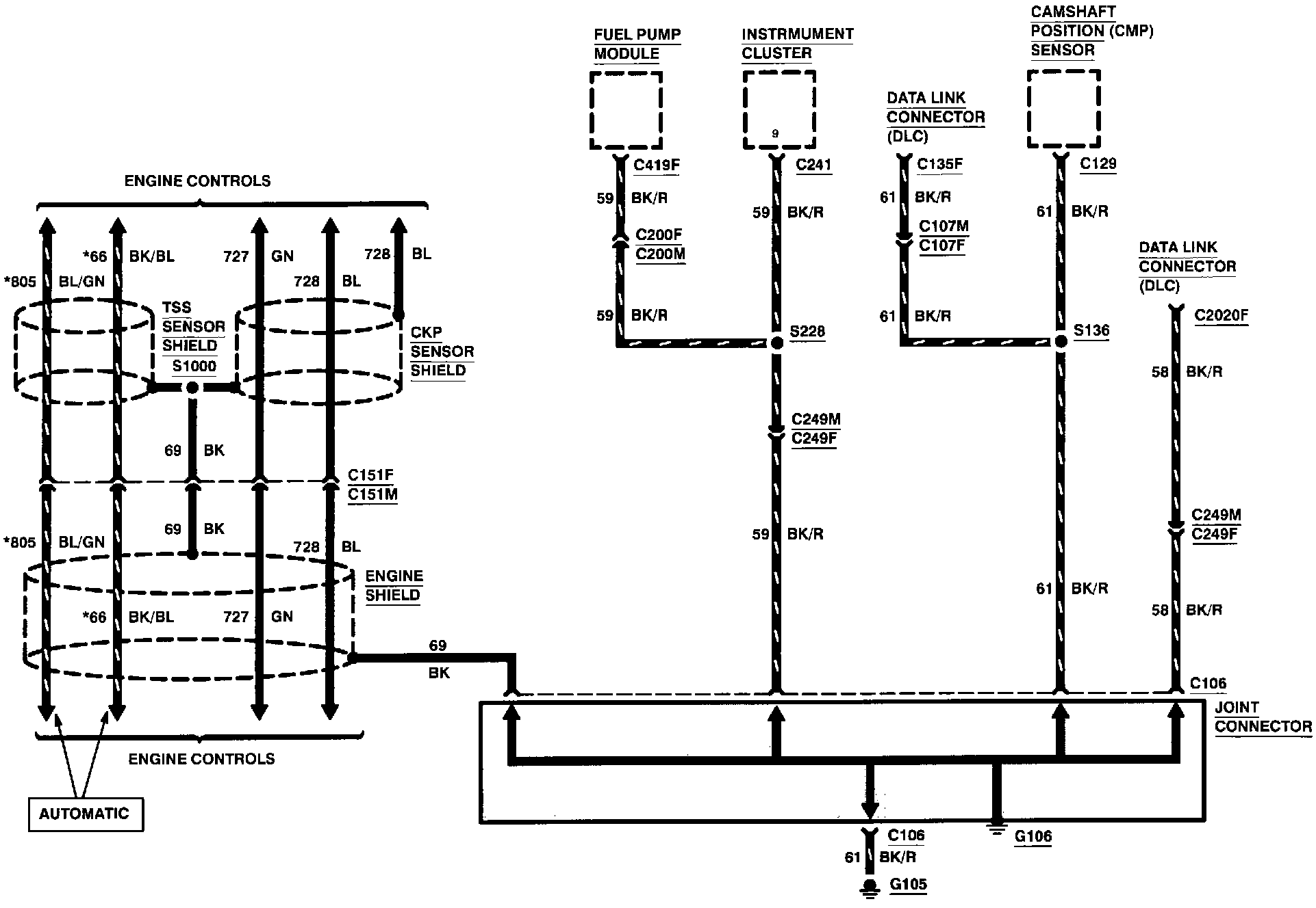

Grounds (G105):
Camshaft Position Sensor
Fuel Pump Module
Instrument Cluster
Joint Connector

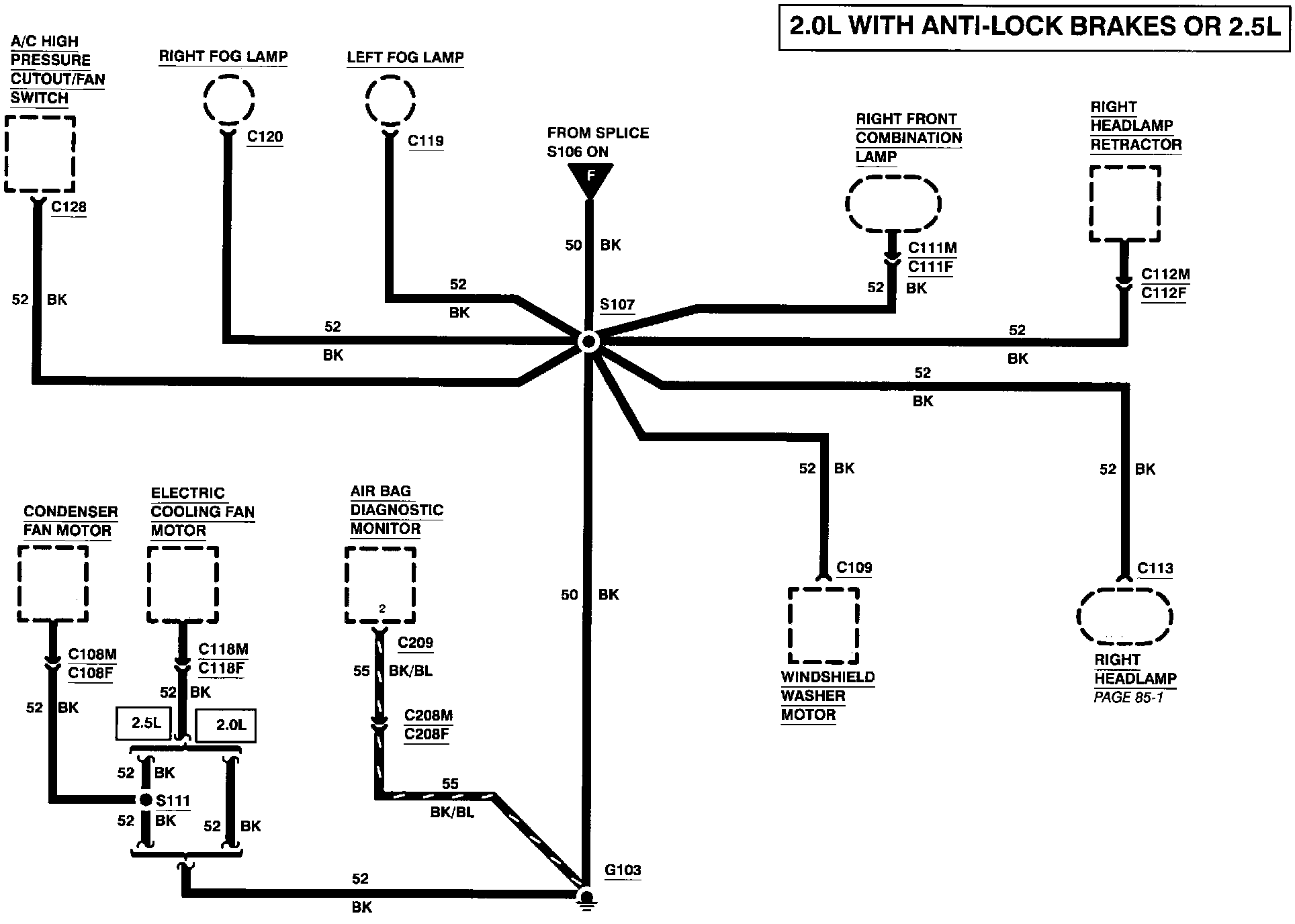

Grounds (G103):
A/C High Pressure Cutout/Fan Switch
Air Bag Diagnostic Monitor
Condenser Fan Motor
Electric Cooling Fan Motor
Left Fog Lamp
Right Fog Lamp
Right Headlamp
