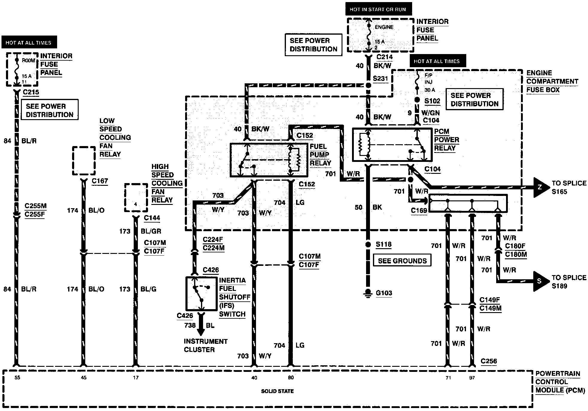

Engine Controls (Part 1 Of 8):
FUEL PUMP RELAY
INERTIA FUEL SHUTOFF SWITCH
PCM POWER RELAY

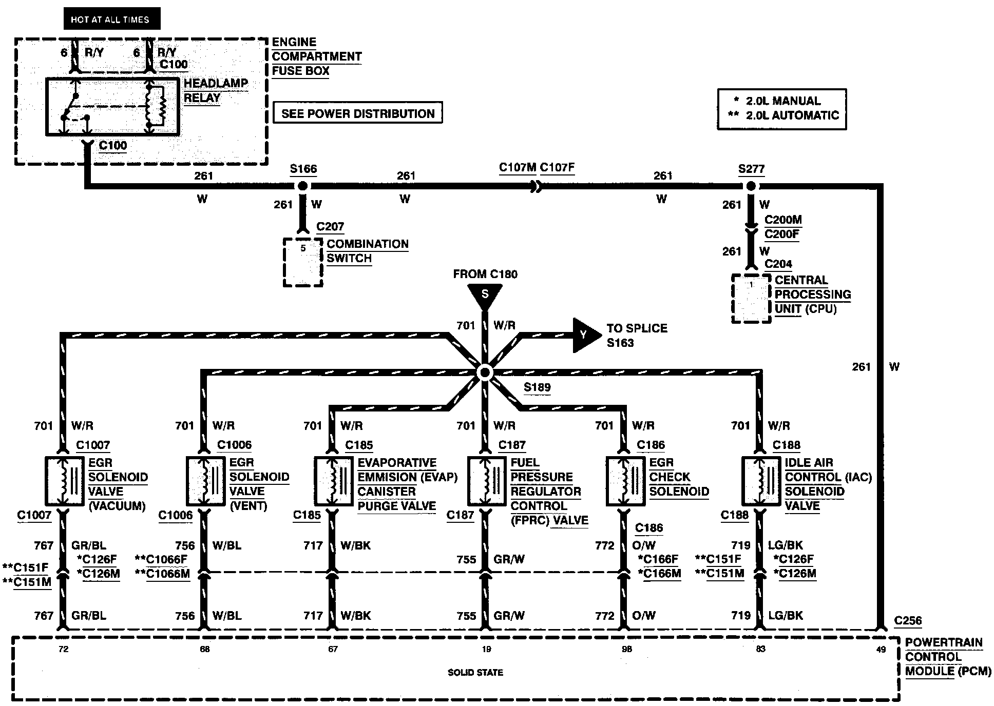

Engine Controls (Part 2 Of 8):
EGR CHECK SOLENOID
EGR SOLENOID VALVE (VACUUM)
EGR SOLENOID VALVE (VENT)
EVAPORATIVE EMISSION CANISTER PURGE VALVE
FUEL PRESSURE REGULATOR CONTROL VALVE
HEADLAMP RELAY
IDLE AIR CONTROL SOLENOID VALVE

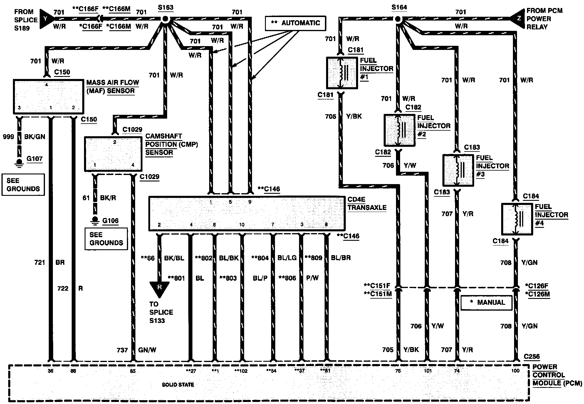

Engine Controls (Part 3 Of 8):
CAMSHAFT POSITION SENSOR
CD4E TRANSAXLE
FUEL INJECTOR #1
FUEL INJECTOR #2
FUEL INJECTOR #3
FUEL INJECTOR #4
MASS AIR FLOW SENSOR

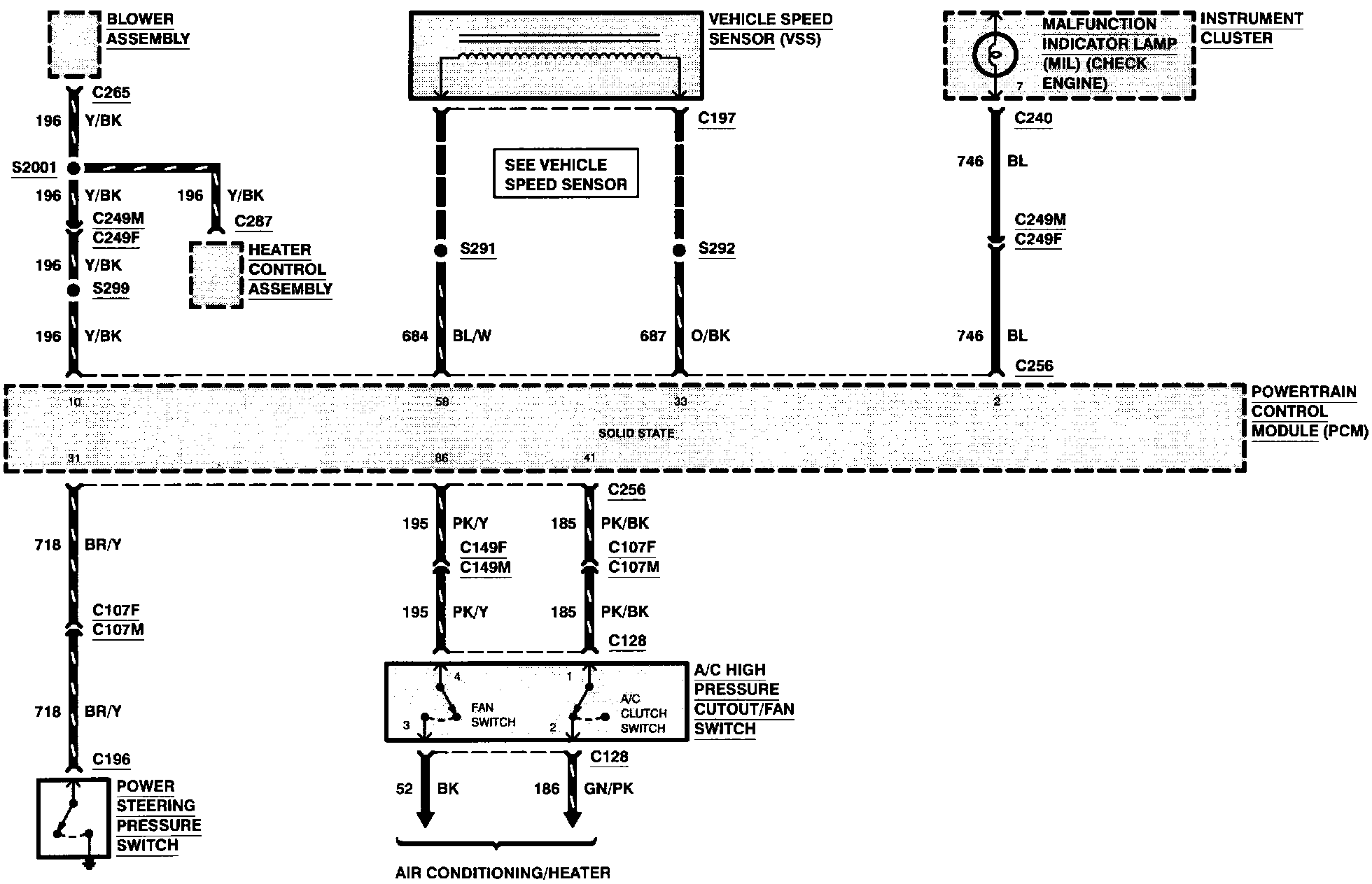

Engine Controls (Part 4 Of 8):
A/C HIGH PRESSURE CUTOUT/FAN SWITCH
POWER STEERING PRESSURE SWITCH
MALFUNCTION INDICATOR LAMP
VEHICLE SPEED SENSOR

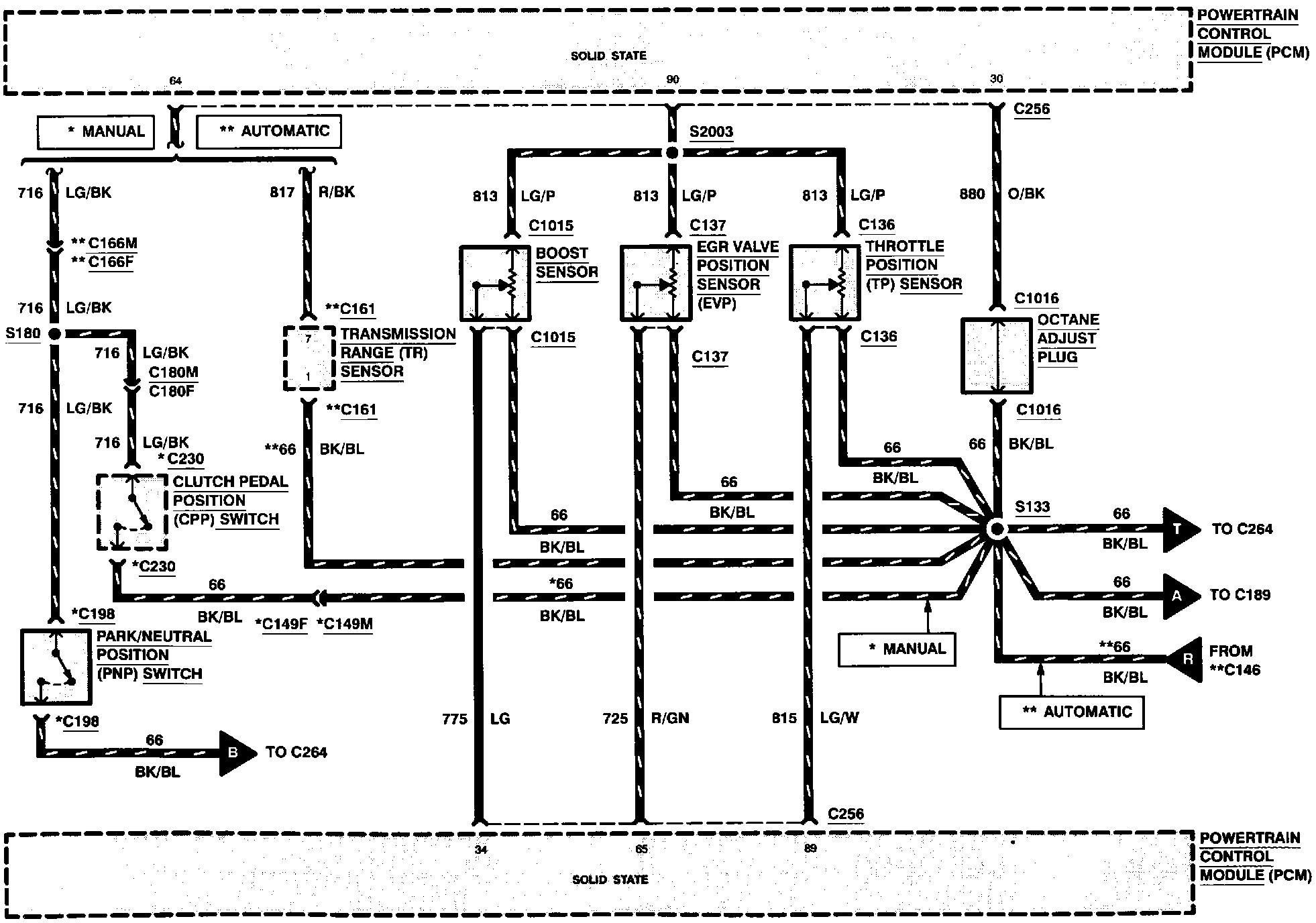

Engine Controls (Part 5 Of 8):
BOOST SENSOR
EGR VALVE POSITION SENSOR
OCTANE ADJUST PLUG
PARK/NEUTRAL POSITION SWITCH
THROTTLE POSITION SENSOR

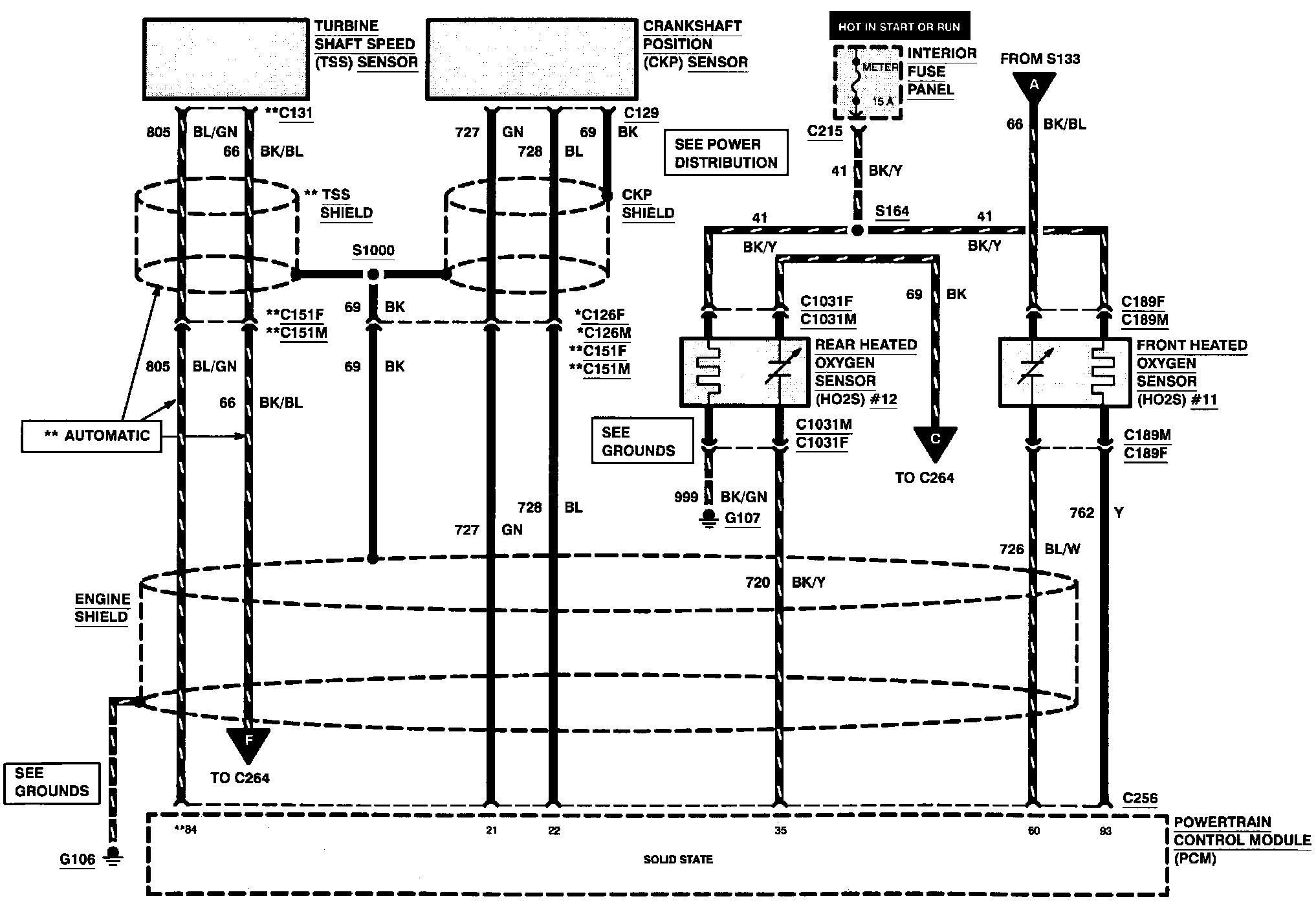

Engine Controls (Part 6 Of 8):
CRANKSHAFT POSITION SENSOR
HEATED OXYGEN SENSOR #11
HEATED OXYGEN SENSOR #12
TURBINE SHAFT SPEED SENSOR

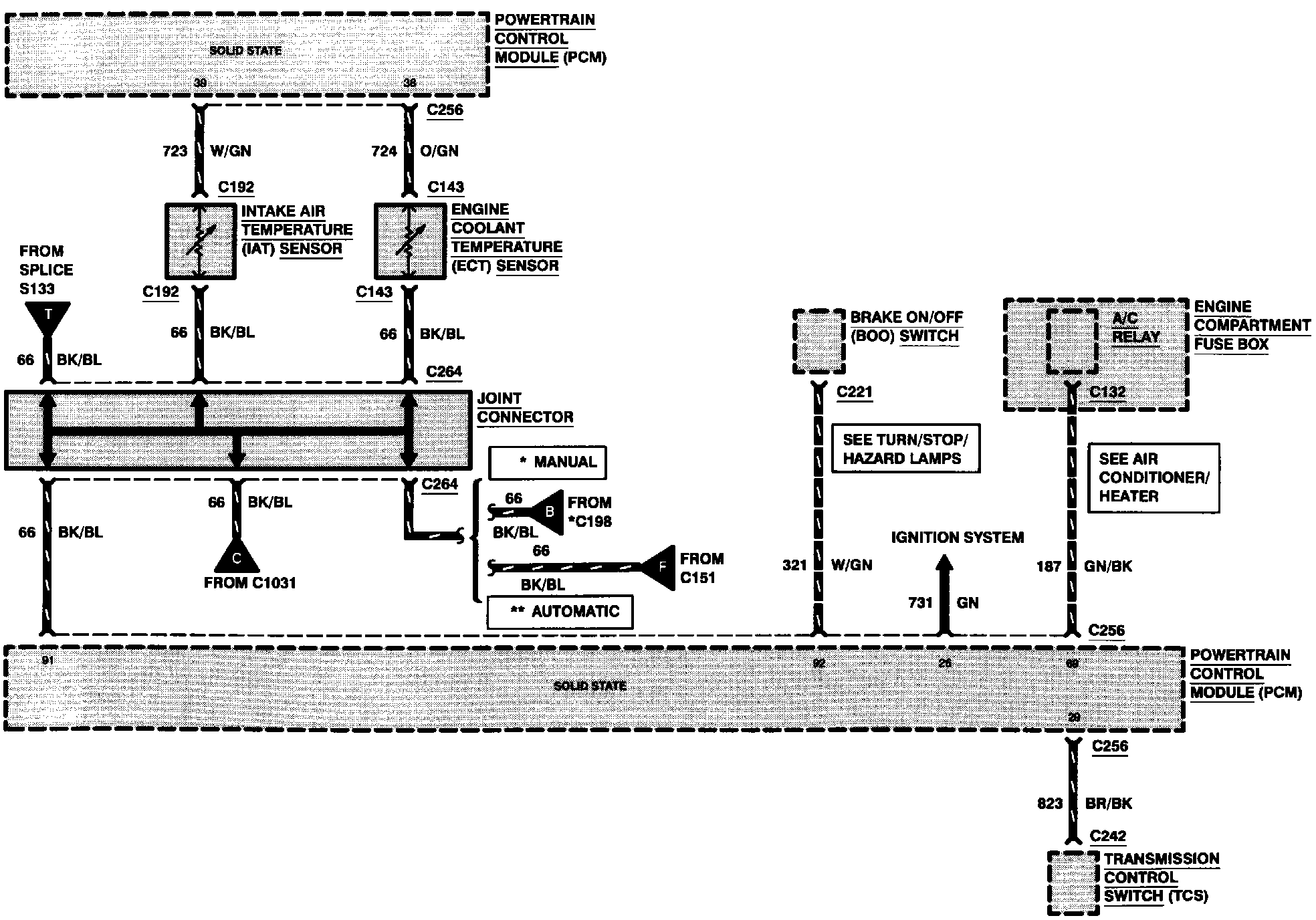

Engine Controls (Part 7 Of 8):
INTAKE AIR TEMPERATURE SENSOR
ENGINE COOLANT TEMPERATURE SENSOR
JOINT CONNECTOR

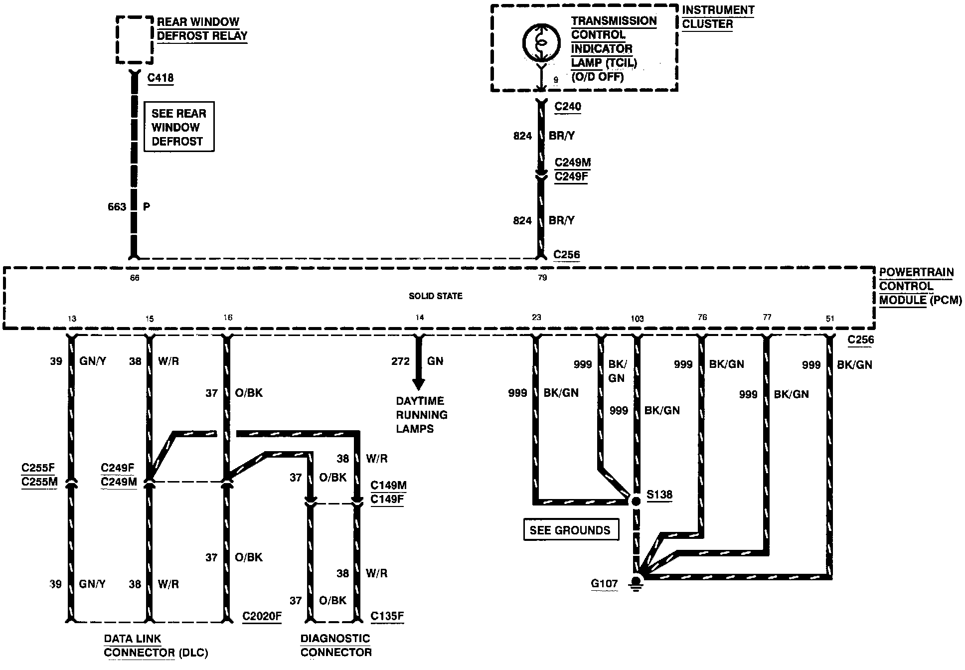

Engine Controls (Part 8 Of 8):
TRANSMISSION CONTROL INDICATOR LAMP
