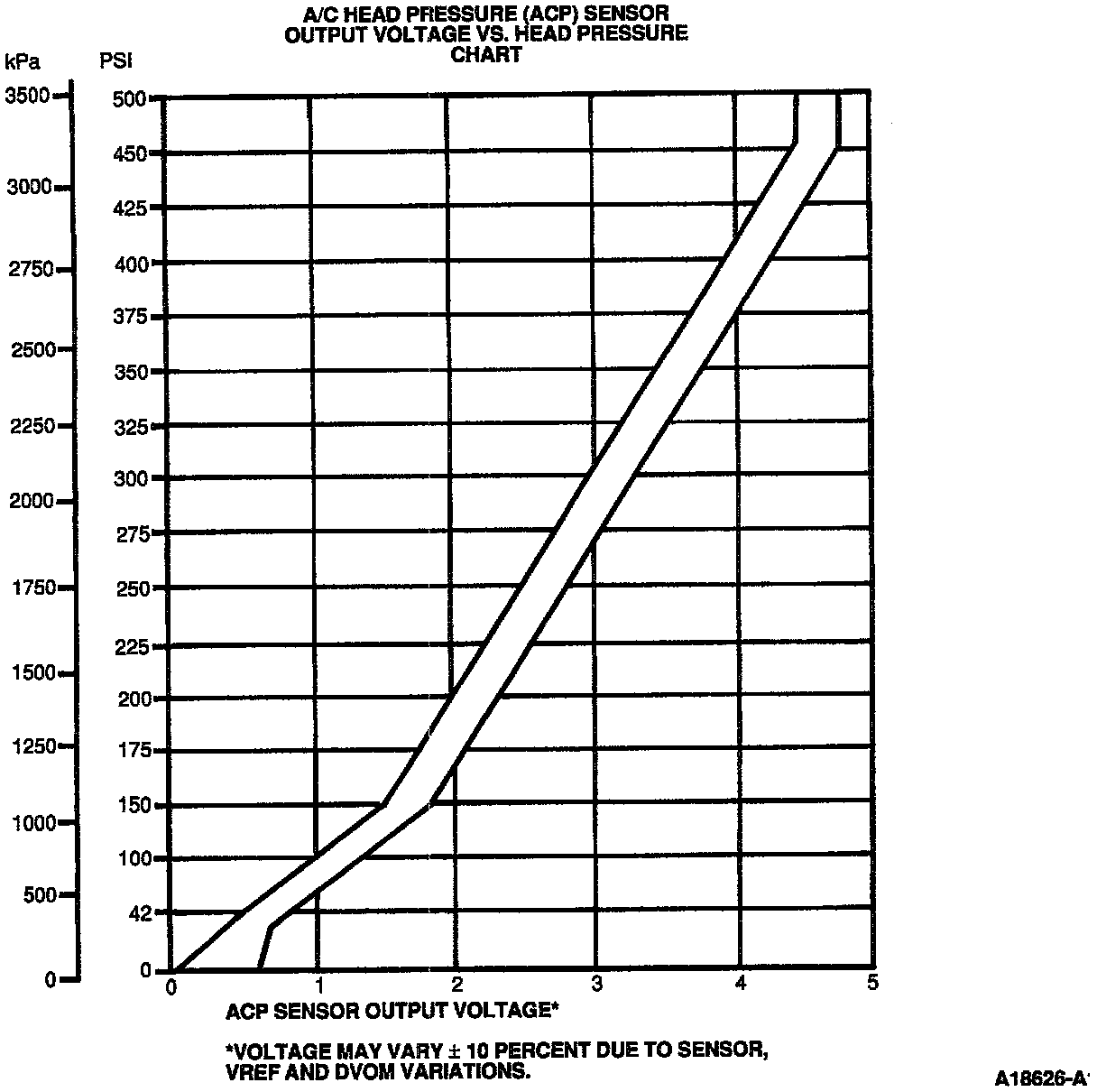

AIR CONDITIONING PRESSURE SENSOR
The Air Conditioning Pressure (ACP) sensor is located in the high pressure (discharge) side of the air conditioning A/C system. The ACP sensor provides a voltage signal to the Powertrain Control Module (PCM) that is proportional to the A/C head pressure. The PCM uses this information for A/C clutch control, cooling fan control and idle speed control.
