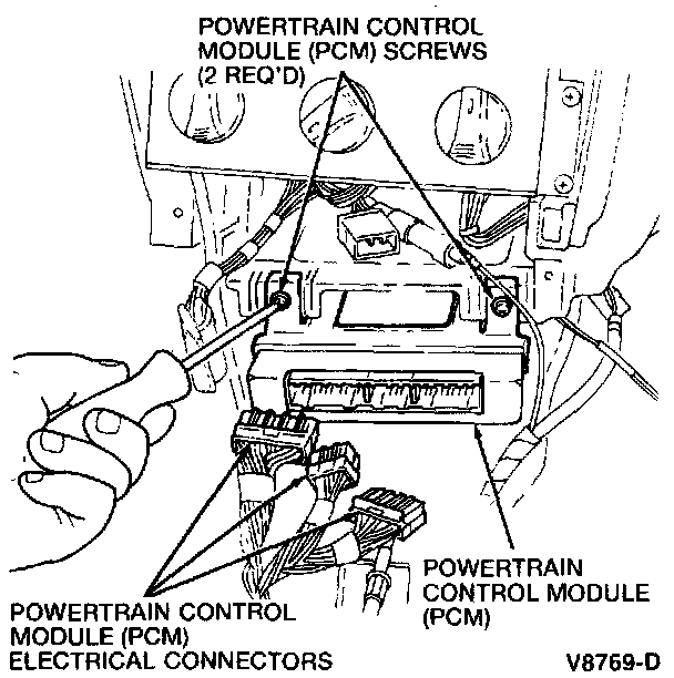

REMOVAL
CAUTION: Electronic modules are sensitive to static electrical charges. If exposed to these charges, damage may result.
2. Remove the floor console and instrument panel insulator.
3. Disconnect the Powertrain Control Module (PCM) electrical connectors.
4. Remove the two PCM screws.
5. Remove the PCM from the console panel.
INSTALLATION
2. Tighten the PCM screws to 3.7 Nm (32 lb in).
