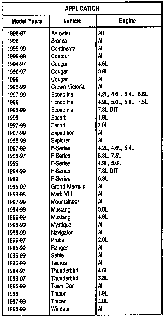

Refer to the Application Chart in this article to use the new 15- to 104-Pin Flash Cable to handle all necessary out-of-vehicle programming of EEC V modules in the vehicles listed. This may allow added flexibility in servicing aftermarket and fleet accounts as well as provide the ability to have modules updated to new calibrations through the Parts Department instead of ordering new parts.
Currently, EEC V modules must be installed in a vehicle to reprogram a new calibration in the module. An aftermarket service center may bring a module to a dealership for a calibration update or may request an updated calibration be installed to a new service part. The EPA regulations require "reasonably priced, timely service" be provided by the dealer. The new 15- to 104-Pin Flash Cable works with the New Generation Star (NGS) Tester to provide the capability to reprogram a calibration on a PCM out of the vehicle.
The 15- to 104-Pin Flash Cable connects between the NGS Tester and PCM 104-pin connector. The proper calibration must be downloaded to the Data Transfer Card through Service Bay Technical System (SBTS). Once the card is inserted into the NGS Tester and the cable is connected, follow the calibration download instructions displayed on the NGS screen.
