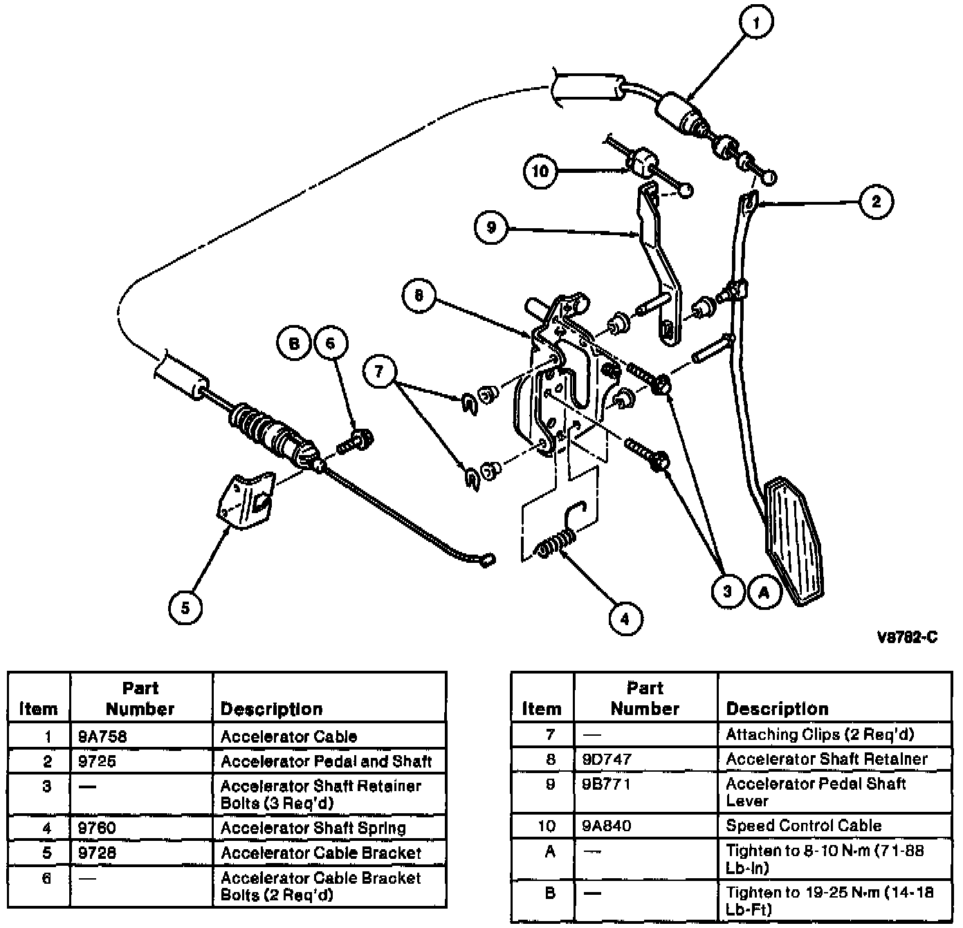

Accelerator Pedal: Description and Operation
Accelerator Pedal And Linkage:
The throttle is controlled by an accelerator cable attached to the accelerator pedal and shaft. On vehicles equipped with speed control, the speed control cable is also attached to the accelerator pedal and shaft.
