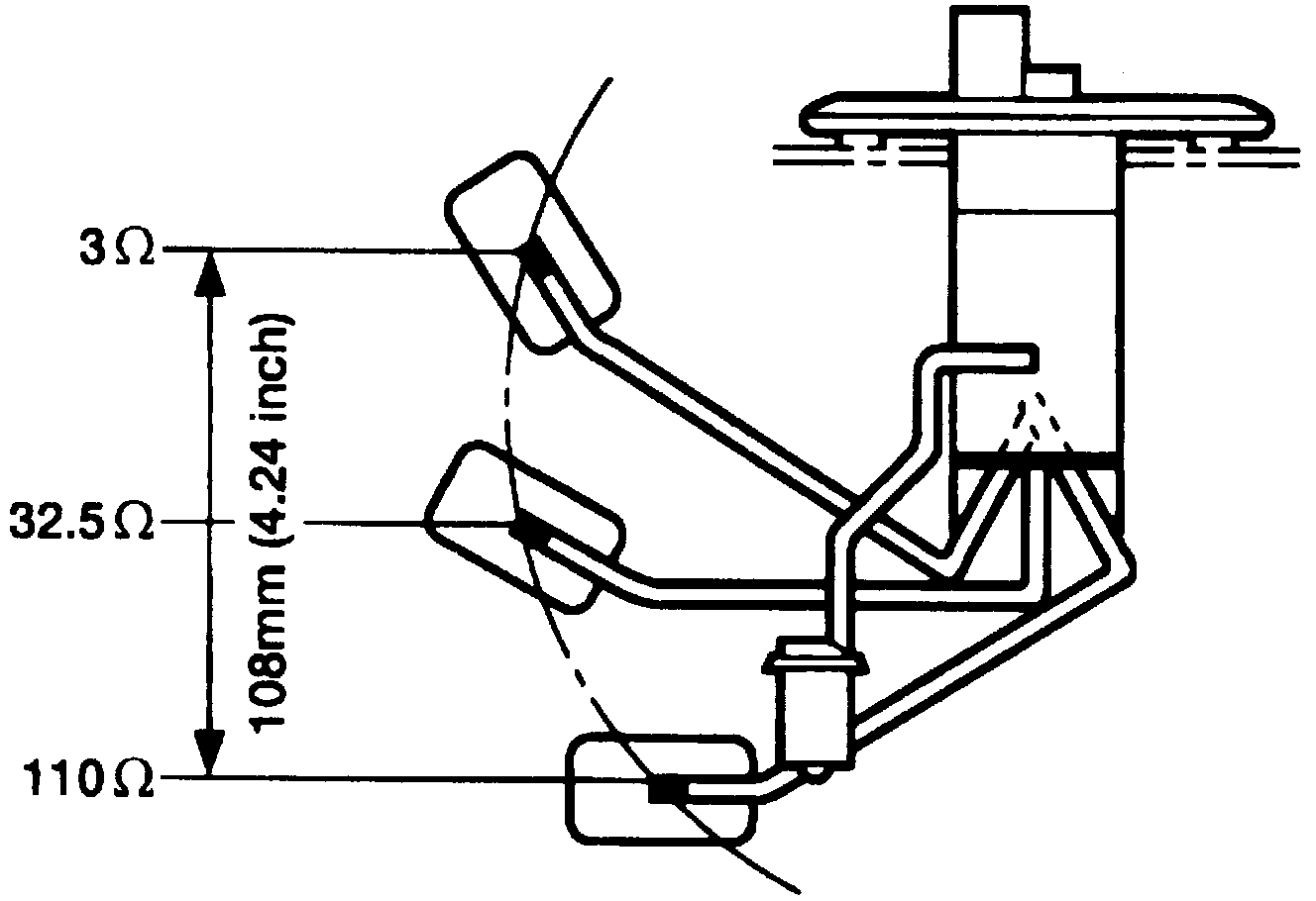

2. Measure resistance between terminals "A" and "D."
Fuel Pump Float Resistance Measurement.:
3. Adjust float to positions shown.
