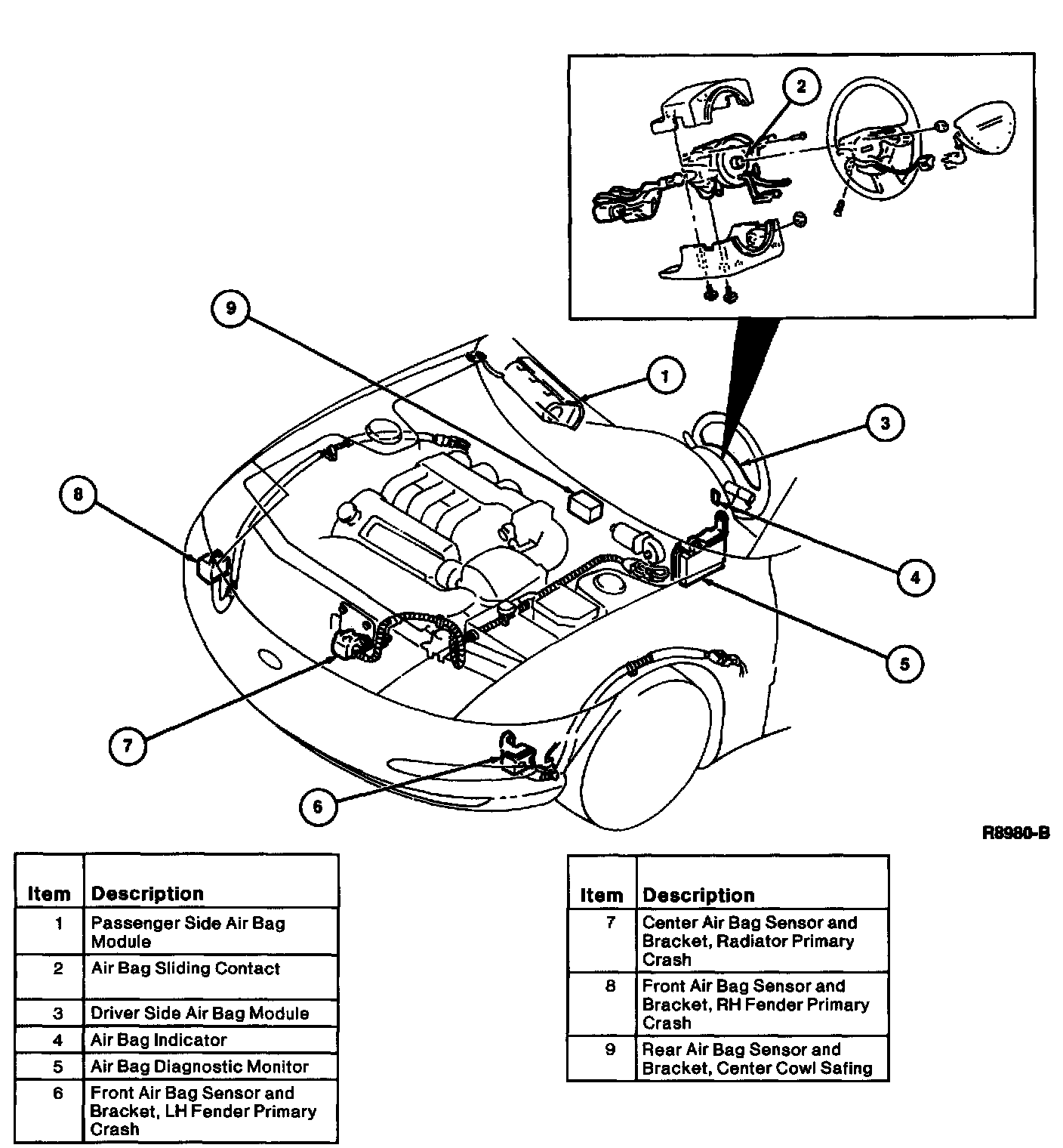

The supplemental air bag restraint electrical system consists of:
- Driver side air bag module
- Passenger side air bag module
- Air bag sliding contact
- LH fender primary crash sensor and bracket
- RH fender primary crash sensor and bracket
- Center radiator primary crash sensor and bracket
- Rear center cowl safing sensor and bracket
- Air bag diagnostic monitor
- Air bag indicator
- Tone generator (internal to the air bag diagnostic monitor)

Sensors
WARNING: VEHICLE SENSOR ORIENTATION IS CRITICAL FOR PROPER SYSTEM OPERATION. IF A VEHICLE EQUIPPED WITH AN AIR BAG SYSTEM HAS BEEN INVOLVED IN A CRASH WHERE THE FENDERS OR GRILLE AREA HAVE BEEN DAMAGED, INSPECT THE SENSOR MOUNTING BRACKETS FOR DEFORMATION. IF DAMAGED, THE SENSOR SHOULD BE REPLACED WHETHER OR NOT THE AIR BAG IS DEPLOYED. IN ADDITION, ENSURE THAT THE BODY STRUCTURE IN THE AREA OF THE SENSOR MOUNTING IS RESTORED TO ITS ORIGINAL CONDITION.
The three air bag sensors are located at the front of the vehicle along the body chassis. The RH and LH fender primary crash front air bag sensor and brackets are located beneath the front fenders on the right and left front bumper cover supports. The radiator primary crash center air bag sensor and bracket is located on the radiator support.

The center cowl safing rear air bag sensor and bracket is located beneath the center console against the bulkhead. It detects the vehicle deceleration rate in the event of a collision.
