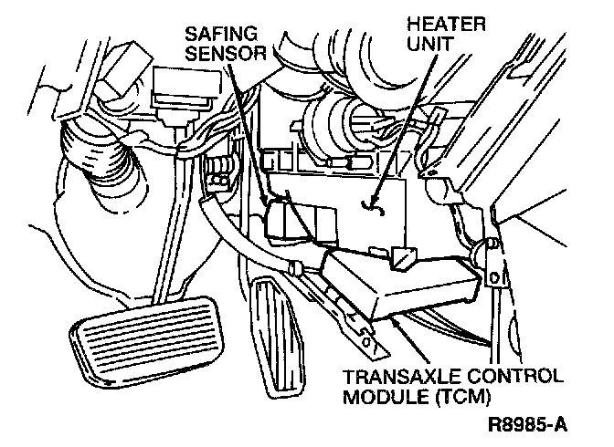

The center cowl safing rear air bag sensor and bracket is located beneath the center console against the bulkhead. It detects the vehicle deceleration rate in the event of a collision.
The center cowl safing rear air bag sensor and bracket consists of:
- A sensing mass
- A bias magnet
- A cylindrical tube
- Two electrical contacts
The design and operation of the center cowl safing rear air bag sensor and bracket is much like that of the LH or RH fender primary crash front air bag sensor and bracket and radiator primary crash center air bag sensor and bracket. The primary difference is the calibration; a center cowl safing rear air bag sensor and bracket magnet is weaker than the LH or RH fender primary crash front air bag sensor and bracket or radiator primary crash center air bag sensor and bracket magnets. The center cowl safing rear air bag sensor and bracket will trigger when the vehicle crashes into a rigid barrier at approximately one or two mph.
The center cowl safing rear air bag sensor and bracket makes sure that, in the event of an electrical short circuit in one of the LH or RH fender primary crash front air bag sensor and bracket or radiator primary crash center air bag sensor and bracket or wiring, the air bags will not deploy when not required.
