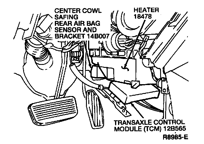

The center cowl safing rear air bag sensor and bracket is mounted on the bulkhead behind the floor console.

1. Position the center cowl safing rear air bag sensor and bracket with the arrow on the sensor facing toward the front of the vehicle and install the center cowl safing rear air bag sensor and bracket bolts. Tighten the two center cowl safing rear air bag sensor and bracket bolts to 7-9 Nm (61-86 lb-in).
