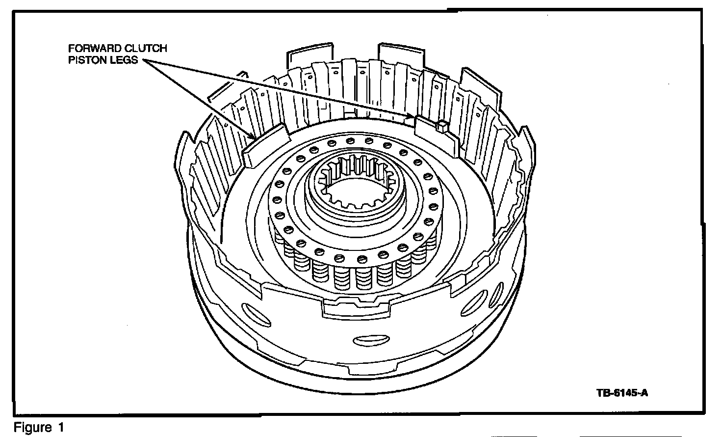

1. Prior to installing the forward and coast clutch plates into the cylinder, note the location of the four (4) forward piston legs (Figure 1).

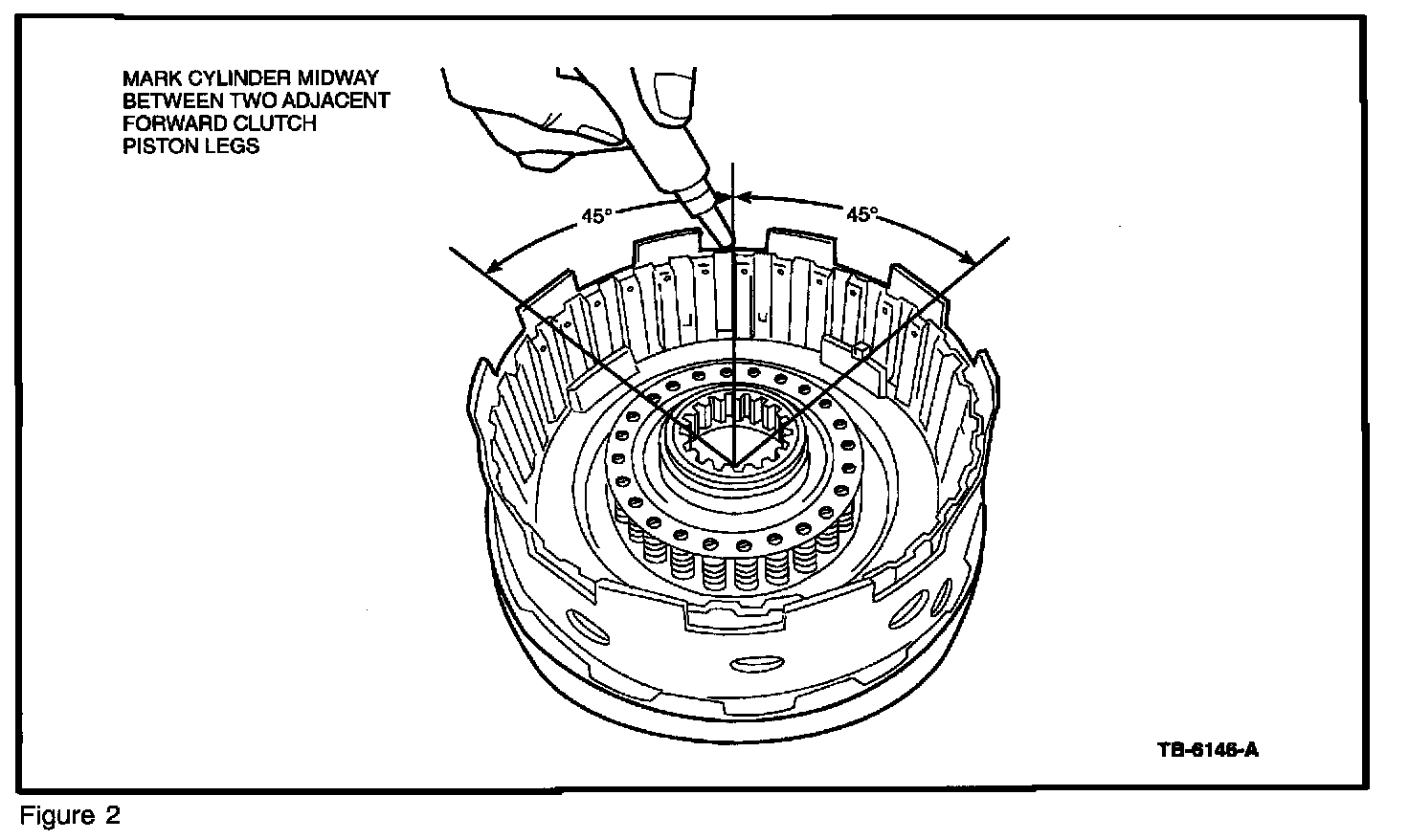

2. Mark the top of the cylinder with a felt tip marker midway between any two adjacent legs (i.e., 45 degrees or 4 external spline teeth from the center of any leg) (Figure 2).
NOTE:
THE FORWARD PISTON LEGS WILL NO LONGER BE VISIBLE WHEN CLUTCH PACK AND RETAINER IS INSTALLED.
3. Following the Service or Workshop Manual procedure, install the clutch plates.
4. Position the ends of the snap ring such that the gap is aligned with the mark on the top of the cylinder (the 45 degree mark) (Figure 3).
