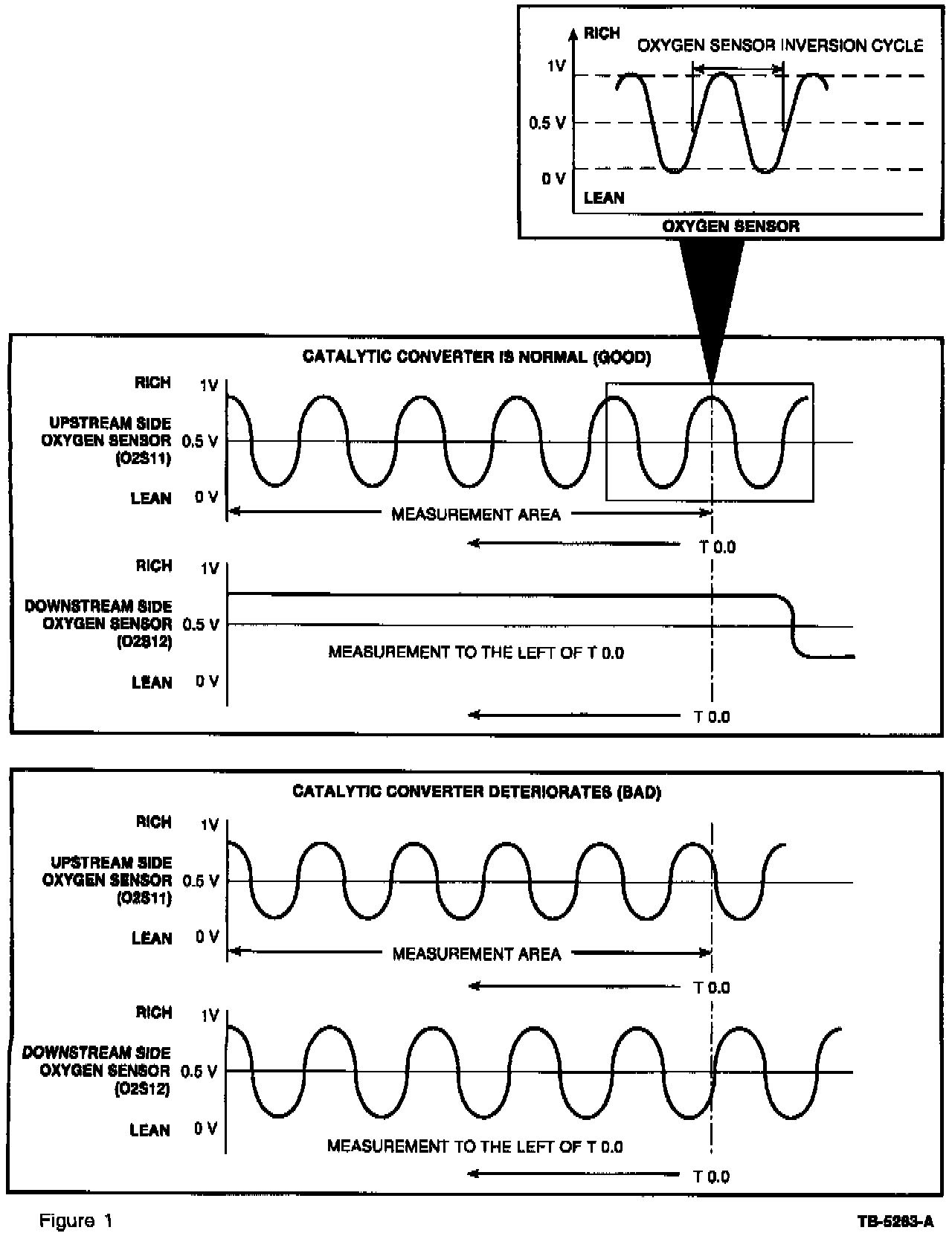

v. Press Key 8 to forward or Key 3 to reverse and select minus (-) to (+) screen located at the bottom of the graph (i.e., -56.5 T 0.0 +12.5).
w. Turn scroll dial until cursor is at "T 0.0."
x. Count and record the number of inversion cycles to the left of "T 0.0" (O2S11). Refer to Figure 1.
y. Press Key 2 to show O2S12 alone.
z. Turn scroll dial until cursor is at "T 0.0."
aa. Count and record the number of inversion cycles to the left of "T 0.0" (O2S12). Refer to Figure 1.
bb. Divide 02511 inversion cycles by the number of O2S12 inversion cycles.
cc. If the ratio of inversion cycles is less than 2.0, replace the Warm-up Catalyst (F62Z-5G232-A). Refer to Section 09-00 of the 1997 Probe Service Manual for replacement procedure.
dd. If the ratio is greater than 2.0, continue to the next Step.
