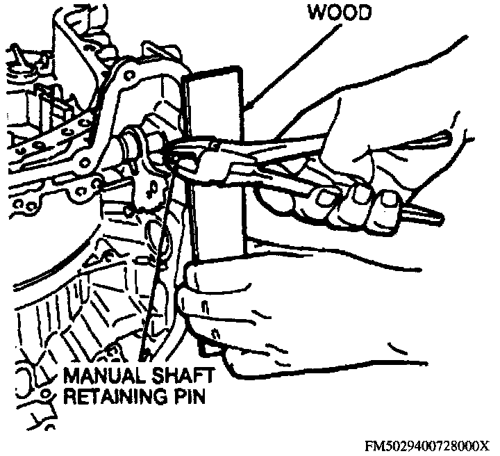

Manual Valve Detent Lever Shaft Retaining Pin Removal:
Manual Shaft Retaining Pin Removal:
7. Remove manual valve detent lever shaft as shown in the Manual Valve Detent Lever Shaft Retaining Pin Removal image and the manual shaft retaining pins as shown in the Manual Shaft Retaining Pin Removal image. Protect transaxle case with a wooden spacer during pin removal, and discard old pins.
8. Remove manual valve detent lever assembly and shaft, then the manual control seal from transaxle case. Discard seal.

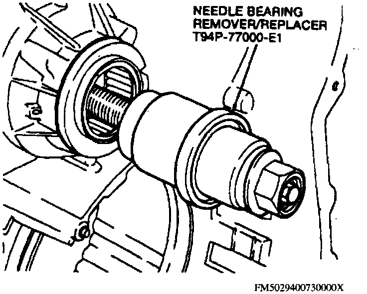

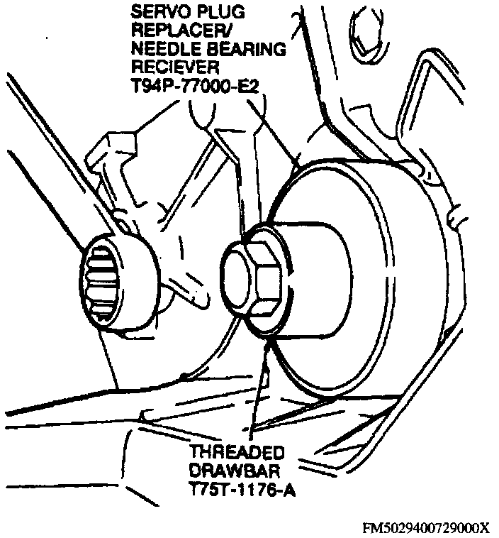

10. If necessary, remove driven sprocket bearing from transaxle case as follows:
Driven Sprocket Bearing Removal Tool Installation:
Driven Sprocket Bearing Removal:
a. Install threaded drawbar tool No. T75T-1176-A, servo plug replacer/needle bearing receiver tool No. T94P-77000-E2, and needle bearing replacer tool No. T94P-77000-E1, or equivalents.
b. Rotate drawbar tool until bearing seats in case.
ASSEMBLE
1. If driven sprocket bearing has been removed from transaxle case, install as follows:
a. Install threaded drawbar tool No. T75T-1176-A, servo plug replacer/needle bearing receiver tool No. T94P-77000-E2, and needle bearing replacer tool No. T94P-77000-E1 or equivalents, as shown in the Driven Sprocket Bearing Removal Tool Installation image and the Driven Sprocket Bearing Removal image.
