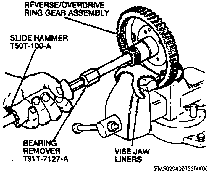

DISASSEMBLEReverse/Overdrive Ring Gear Bearing Removal:
1. Use slide hammer tool No. T50T-100-A, input shaft bearing remover tool No. T91T-7127-A and bearing cup remover tool No. T87P-7120-D or equivalents to remove reverse/overdrive ring gear bearing assembly.
Stator Support Bearing Removal:
2. Use bearing cup remover tool No. T87P-7120-D and impact slide hammer tool No. T50T-100-A or equivalents to remove stator support bearing assembly.
