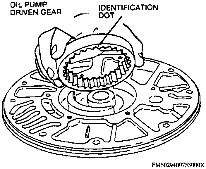

Oil Pump Driven Gear Installation:
1. Install driven gear in oil pump body with identification dot facing down.
2. Install drive gear and insert in oil pump body.

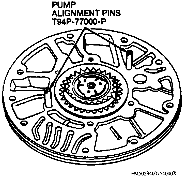

Pump Alignment Pin Installation:
4. Install pump alignment pins tool No. T94P-77000-P or equivalent in oil pump body as shown in the Pump Alignment Pin Installation image, then fill pump gear cavity with suitable ATF.
5. Install separator plate, gasket, pump support assembly, and bolts on oil pump body. Tighten four pump support bolts.
6. Remove alignment pins and tighten remaining two pump support bolts, then install oil pump seal on body.
