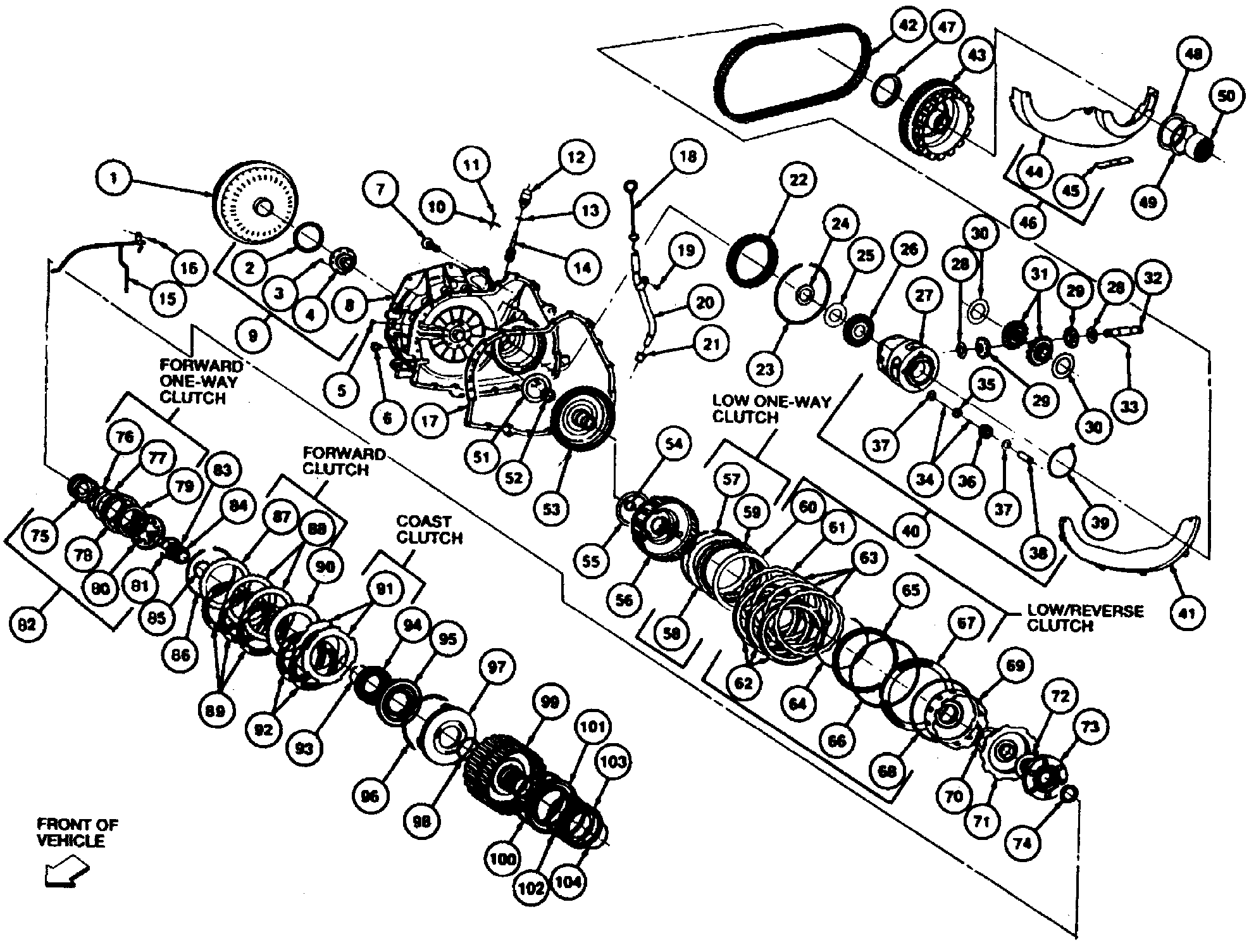

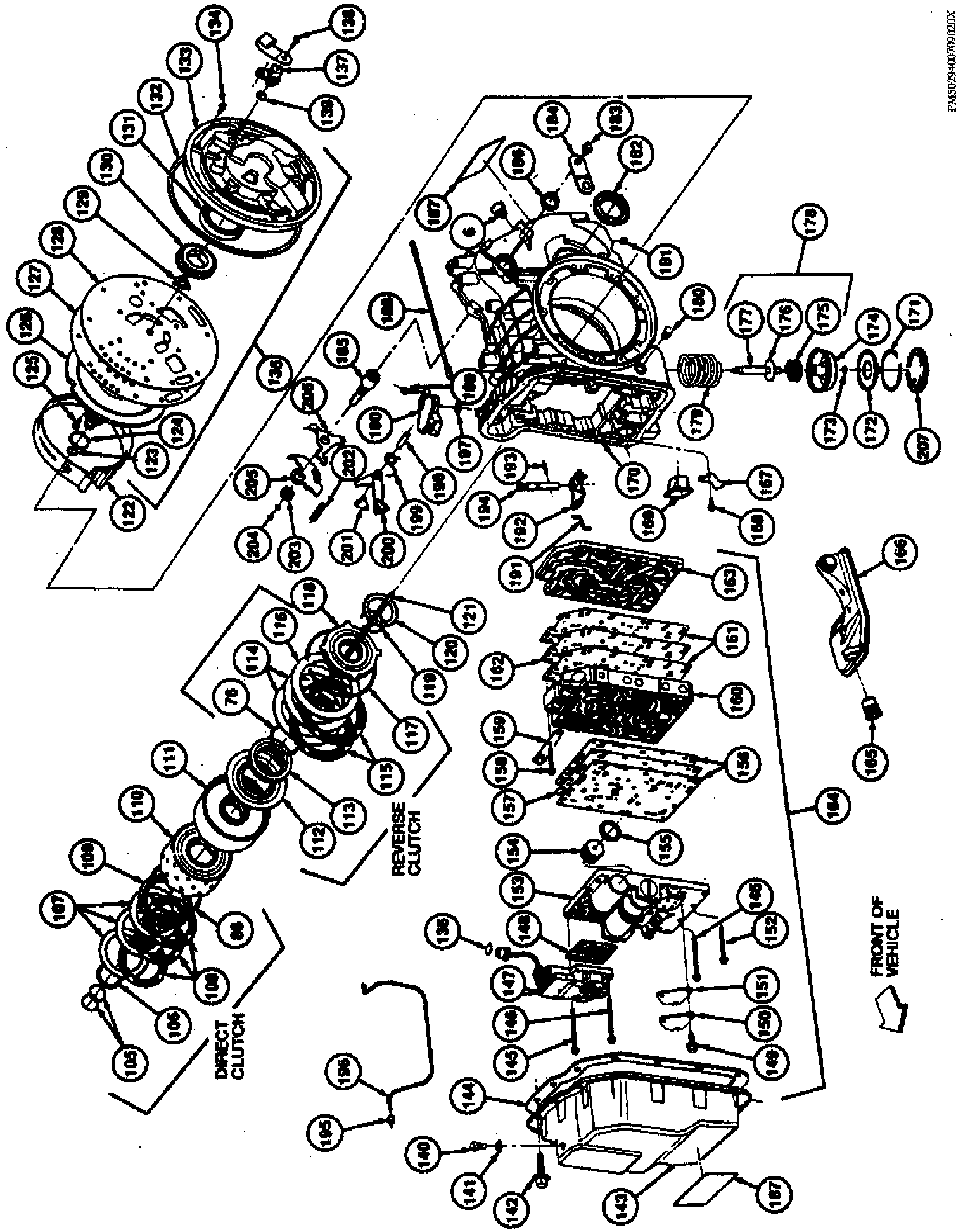

DISASSEMBLEExploded View Of Transaxle, (Part 1 Of 5):
Exploded View Of Transaxle, (Part 2 Of 5):
Exploded View Of Transaxle, (Part 3 Of 5):
Exploded View Of Transaxle, (Part 4 Of 5):
Exploded View Of Transaxle, (Part 5 Of 5):
NOTE: Refer to the Exploded View Of Transaxle image throughout overhaul procedures.

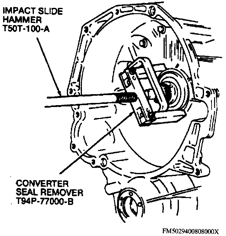

4. Using converter seal remover tool No. T94P-77000-B and impact slide hammer tool No. T50T-1O0-A or equivalents, remove and discard converter impeller hub seal, then the righthand and lefthand differential oil seals.

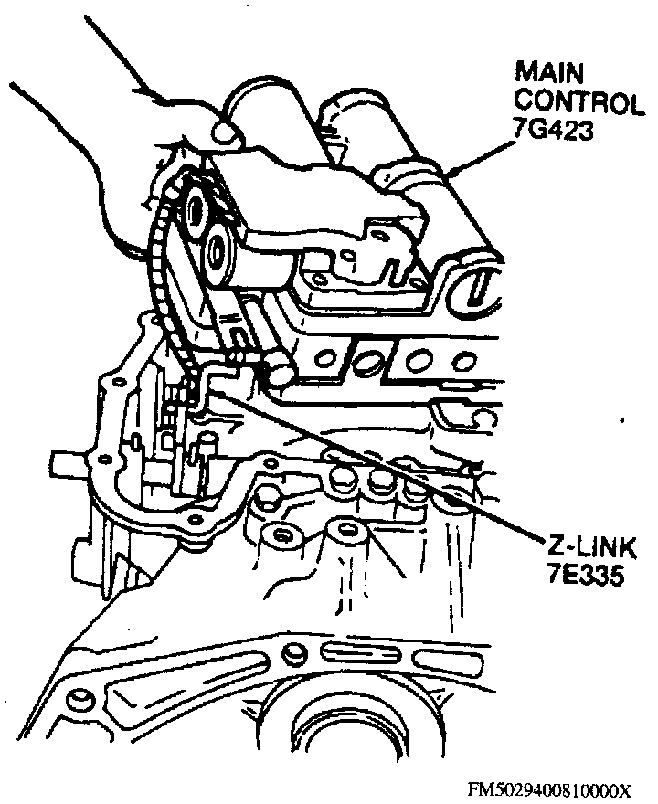

Z-link Location:
10. Pull main control slightly away from transaxle case, then disconnect Z-link at manual valve.
11. Disconnect electrical connector at case bore, then remove main control from case.

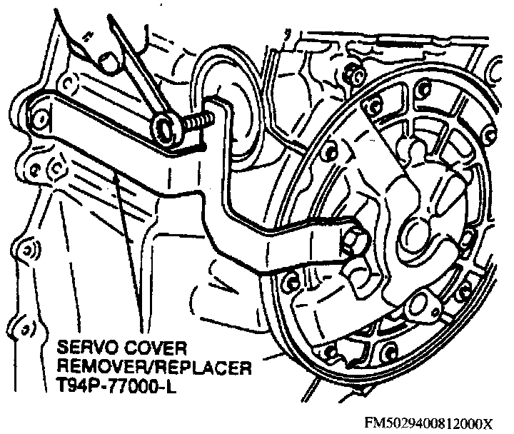

13. Using jet plug remover tool No. T77L-9533-B or equivalent, remove servo cover cap from transaxle case and discard, then attach servo cover tool No. T94P-77000-L or equivalent to oil pump assembly.
14. Compress servo cover assembly as shown in the Servo Cover Compression image, then remove servo cover tool and cover assembly.
CAUTION: Because servo and cover are spring loaded, use caution during removal.

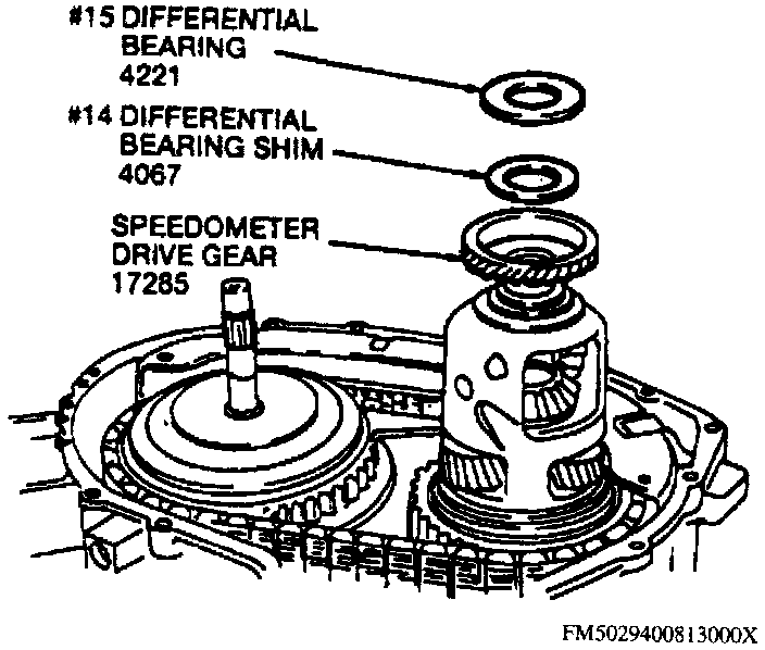

Differential Bearing, Shim, And Speedometer Drive Gear:
17. Remove differential bearing and shim, then the speedometer drive gear.

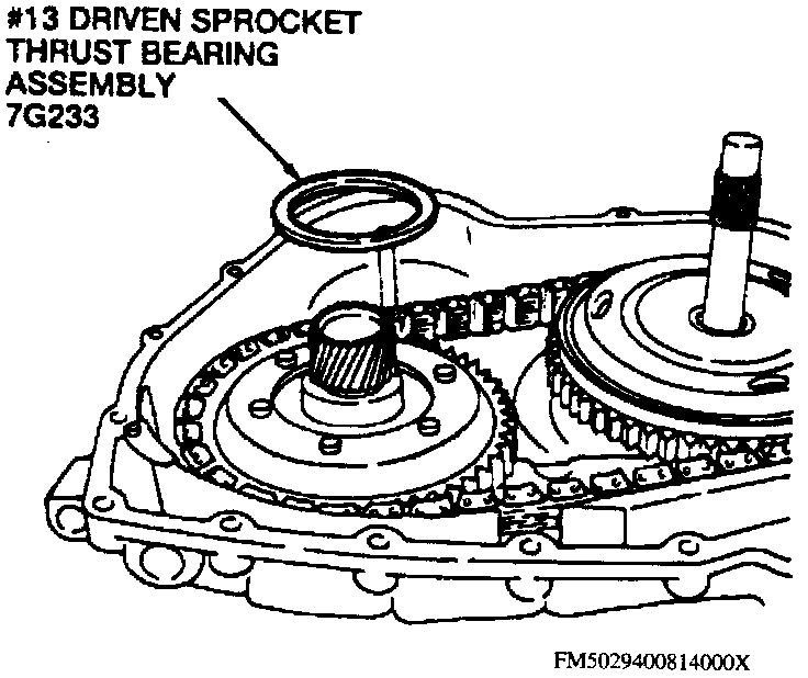

Driven Sprocket Thrust Bearing Assembly:
19. Remove driven sprocket thrust bearing assembly, then the drive sprocket thrust washer from reverse/overdrive ring gear assembly. Washer may be attached to converter housing.

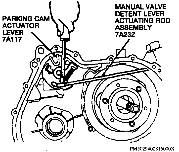

Manual Valve Detent Lever Actuating Rod And Parking Cam Actuator Lever:
25. Separate socket end of manual valve detent lever actuating rod from parking cam actuator lever, then from manual valve detent lever.

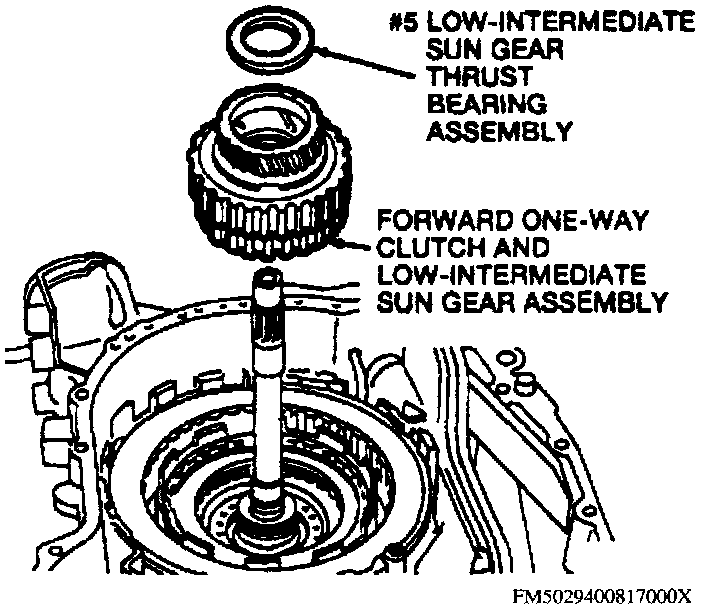

Low/intermediate Sun Gear, Thrust Bearing, And Forward One-way Clutch Assemblies:
29. Remove low/intermediate carrier assembly, then the low/intermediate sun gear thrust bearing, forward one-way clutch, and low/intermediate sun gear assembly.
30. Remove turbine shaft thrust bearing, then the shaft. Bearing may be attached to forward one-way clutch and low/intermediate sun gear assembly.
