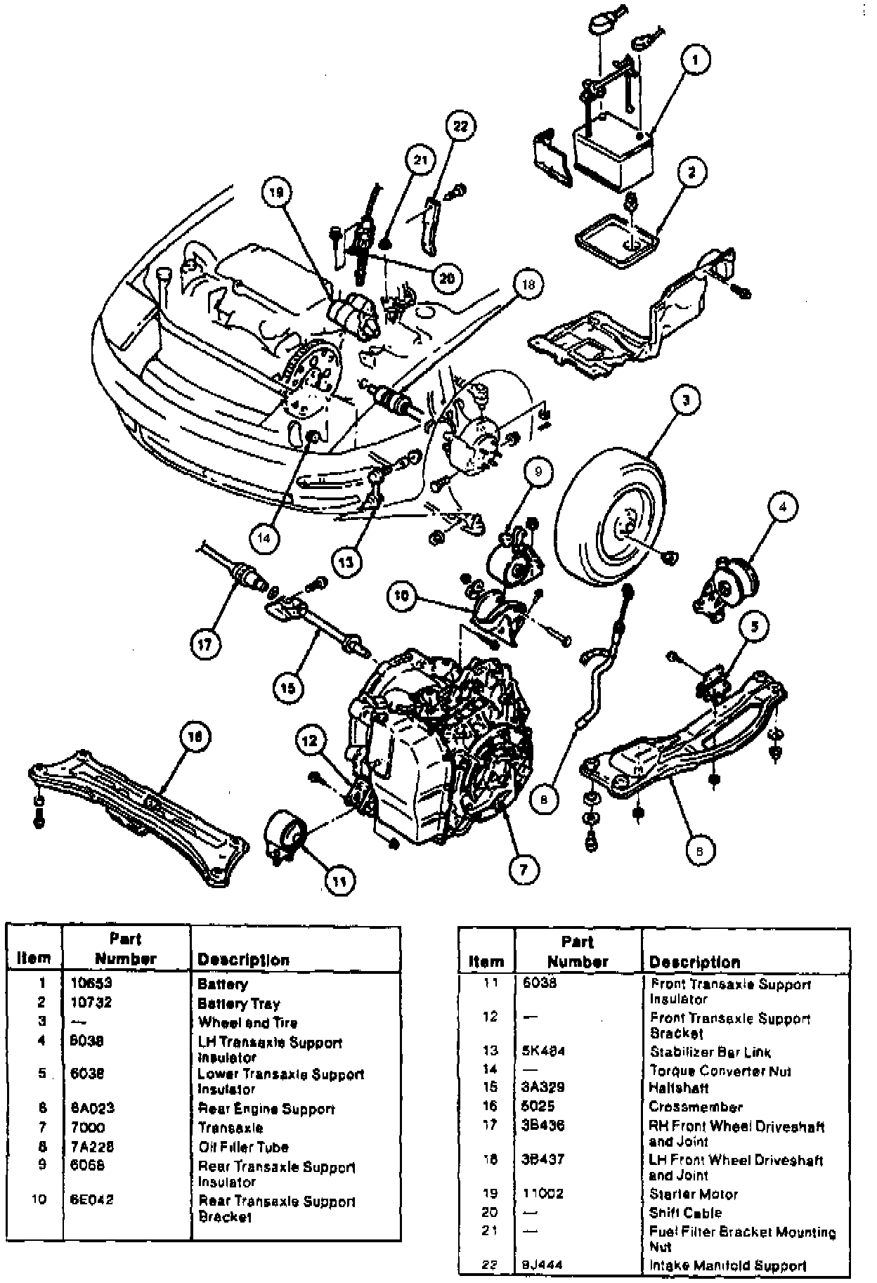

REMOVALTransaxle Replacement:
NOTE: Refer to the Transaxle Replacement image when replacing transaxle.

1. Raise transaxle and install on engine block, then align torque converter studs to flywheel and install transaxle to engine bolts. Tighten bolts (B) and (C) as shown in the Transaxle To Engine Bolts image.

8. Raise and support vehicle, then install rear engine support. Tighten bolts (A), (B) and (C) to specifications as shown in the Rear Engine Support Nuts And Bolts image.

16. Install remaining transaxle to engine bolts, then tighten transaxle to engine bolts (A) as shown in the Transaxle To Engine Bolts image.
