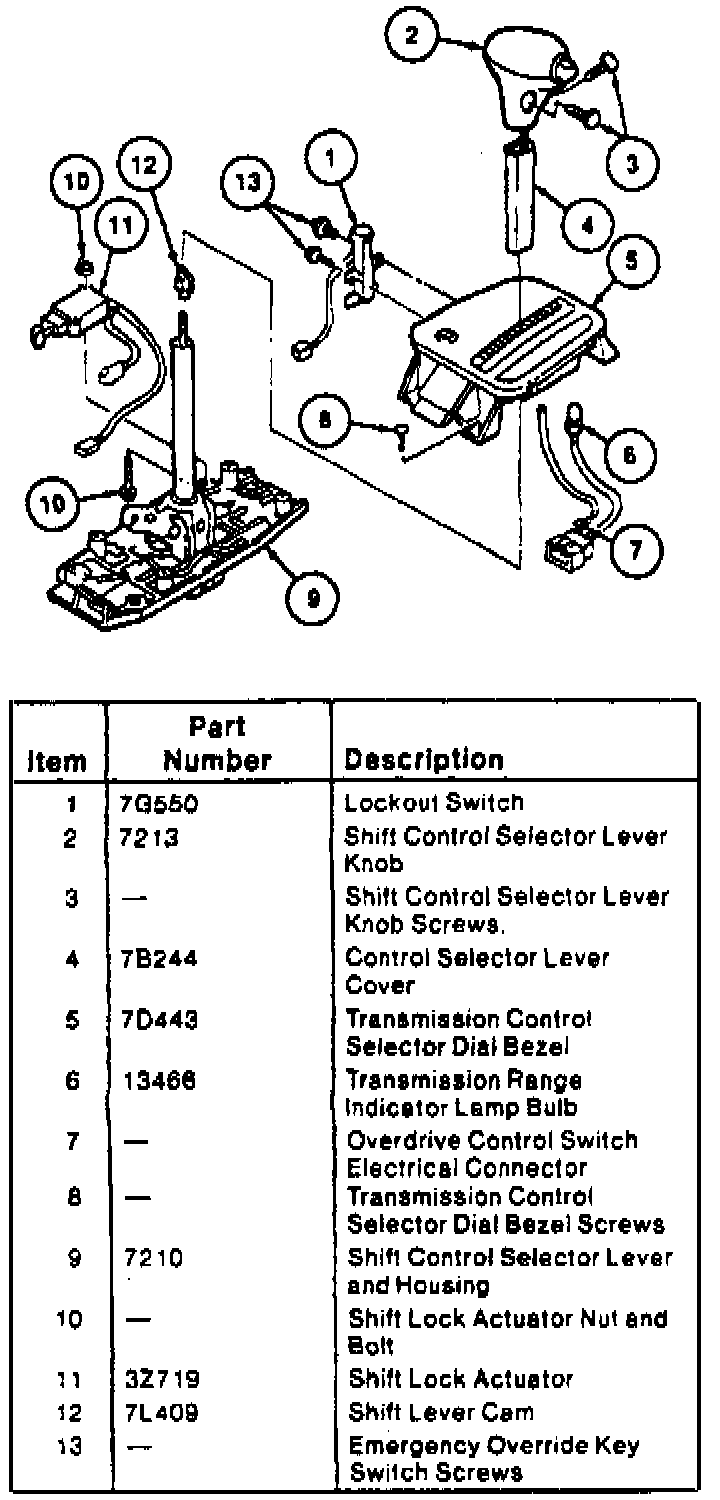

Selector Lever Assembly:
NOTE: Refer to the Selector Lever Assembly image when replacing selector lever and housing.
1. Disconnect battery ground cable, then remove console finish panel.
2. Remove four transmission control selector dial bezel screws, then disconnect park range switch, overdrive switch, and emergency override switch electrical connectors.
3. Using a suitable screwdriver, pry shift cable and bracket from selector lever and housing.
4. Remove lock tab cover, then squeeze tabs on shift cable and bracket to remove from selector lever and housing.
Interlock Cable Locknut:
5. Loosen interlock cable locknut, then disconnect shift lock actuator electrical connector.
6. Remove selector lever and housing nuts and bolt, then lift lever, housing and seal off studs.
