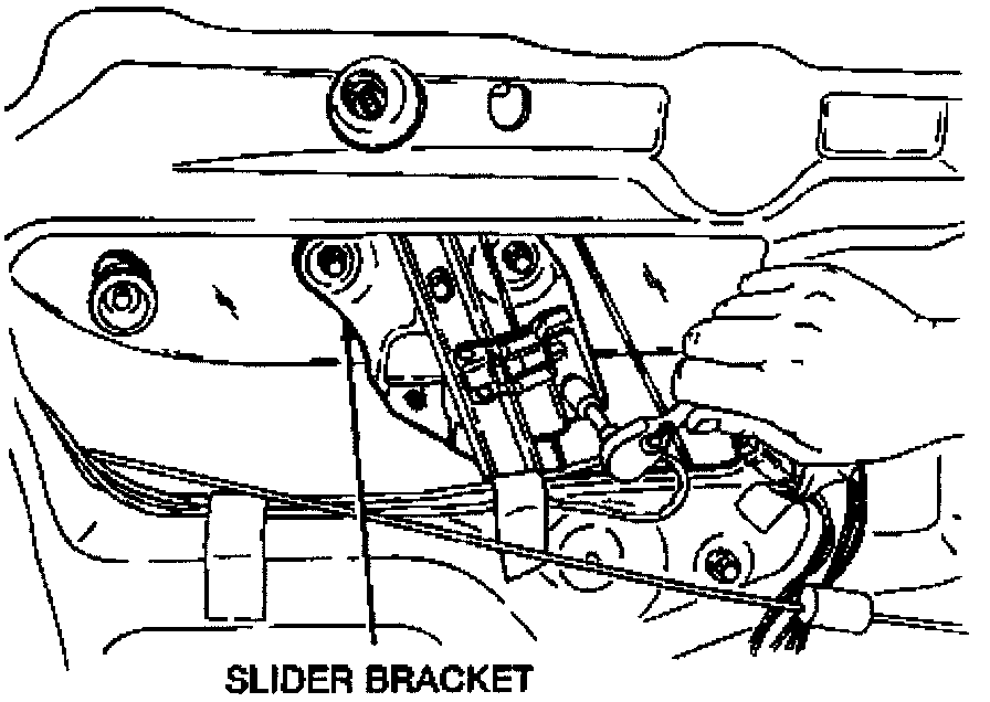

c. Raise the front door window glass and channel.
d. Remove the slider bracket bolt.
e. Remove the two door window glass inner stabilizer bolts and remove the door window glass inner stabilizers.
f. Remove the front door window glass and channel.

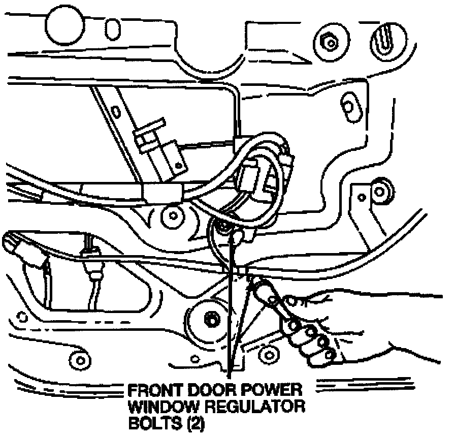

2. Remove the two front door power window regulator bolts.
3. Remove the two front door power window regulator nuts.
4. Disconnect the front door power window regulator electrical connector.
5. Remove the front door power window regulator through the service hole.
