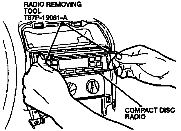

REMOVAL
2. Remove the instrument panel finish panel.
3. Insert the Radio Removing Tool T87P-19061-A into the face plate holes until the tension of the tool locking into place can be felt.
4. Flex outward on both sides of the radio chassis simultaneously and pull the radio chassis from the instrument panel using the tool as handles.
5. Disconnect the electrical connectors and the radio antenna lead in cable from the radio chassis.
INSTALLATION
1. Remove the Radio Removing Tool T87P-19061-A from the face plate holes.
2. Connect the electrical connectors and the radio antenna lead in cable into the radio chassis.
3. Install the radio chassis.
4. Install the instrument panel finish panel.
5. Connect the battery ground cable.
