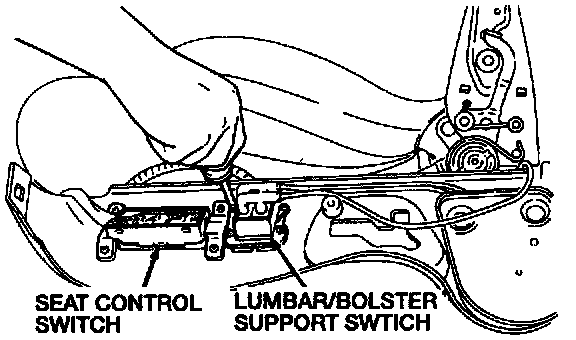

7. Remove the four seat control switch screws.
8. Disconnect the seat control switch electrical connector.
9. Remove the seat control switch.
10. Remove the four lumbar/bolster support switch screws.
11. Disconnect the lumbar/bolster support switch electrical connector.
12. Disconnect the front seat back pad adjusting hose from the lumbar/bolster support switch.
13. Remove the lumbar/bolster support switch.
