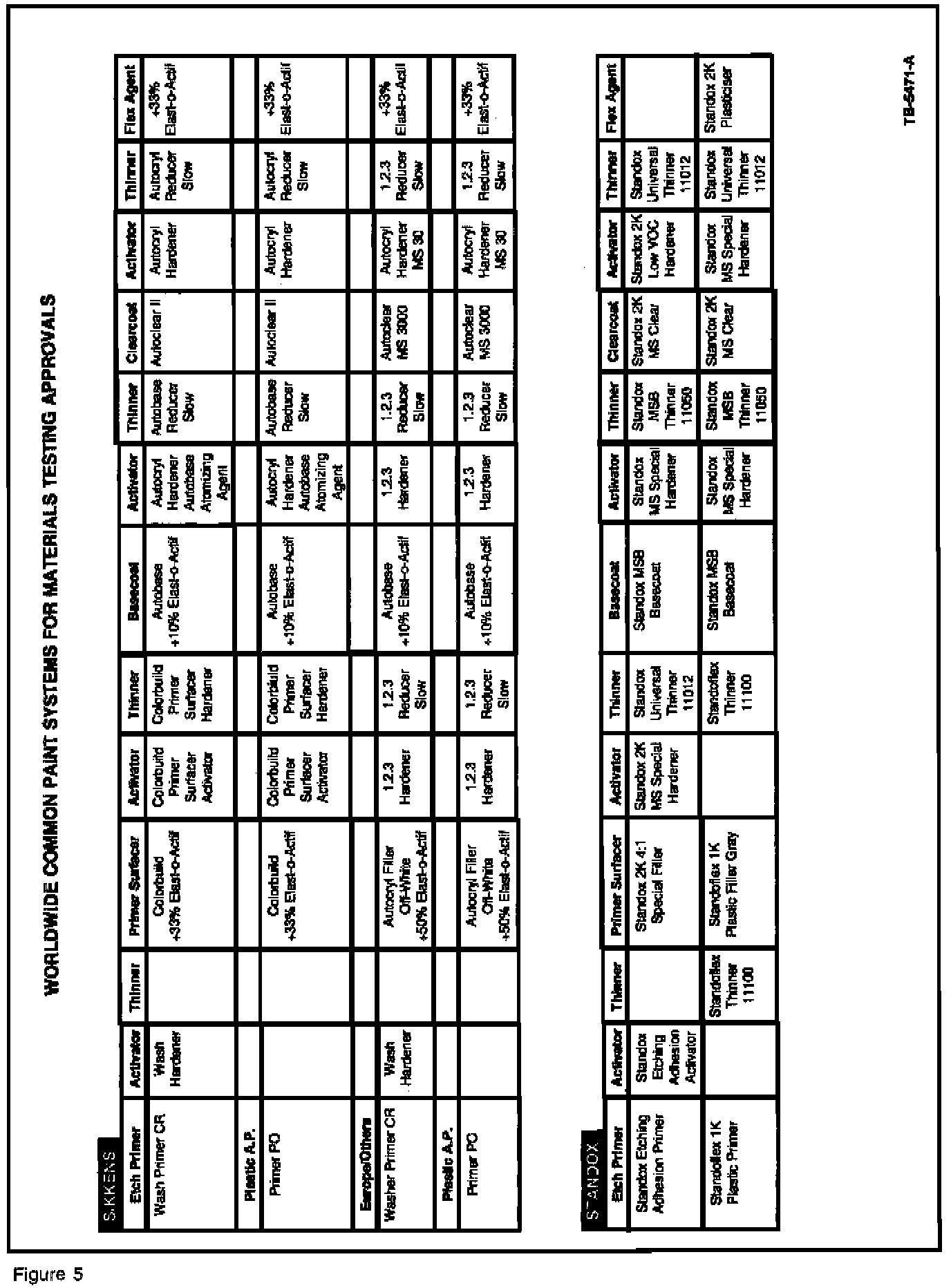

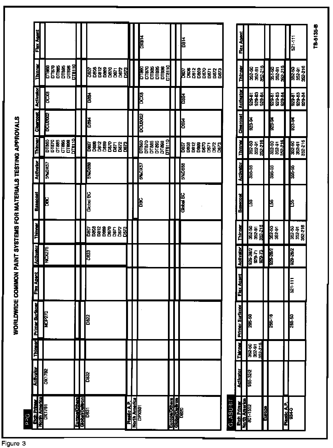

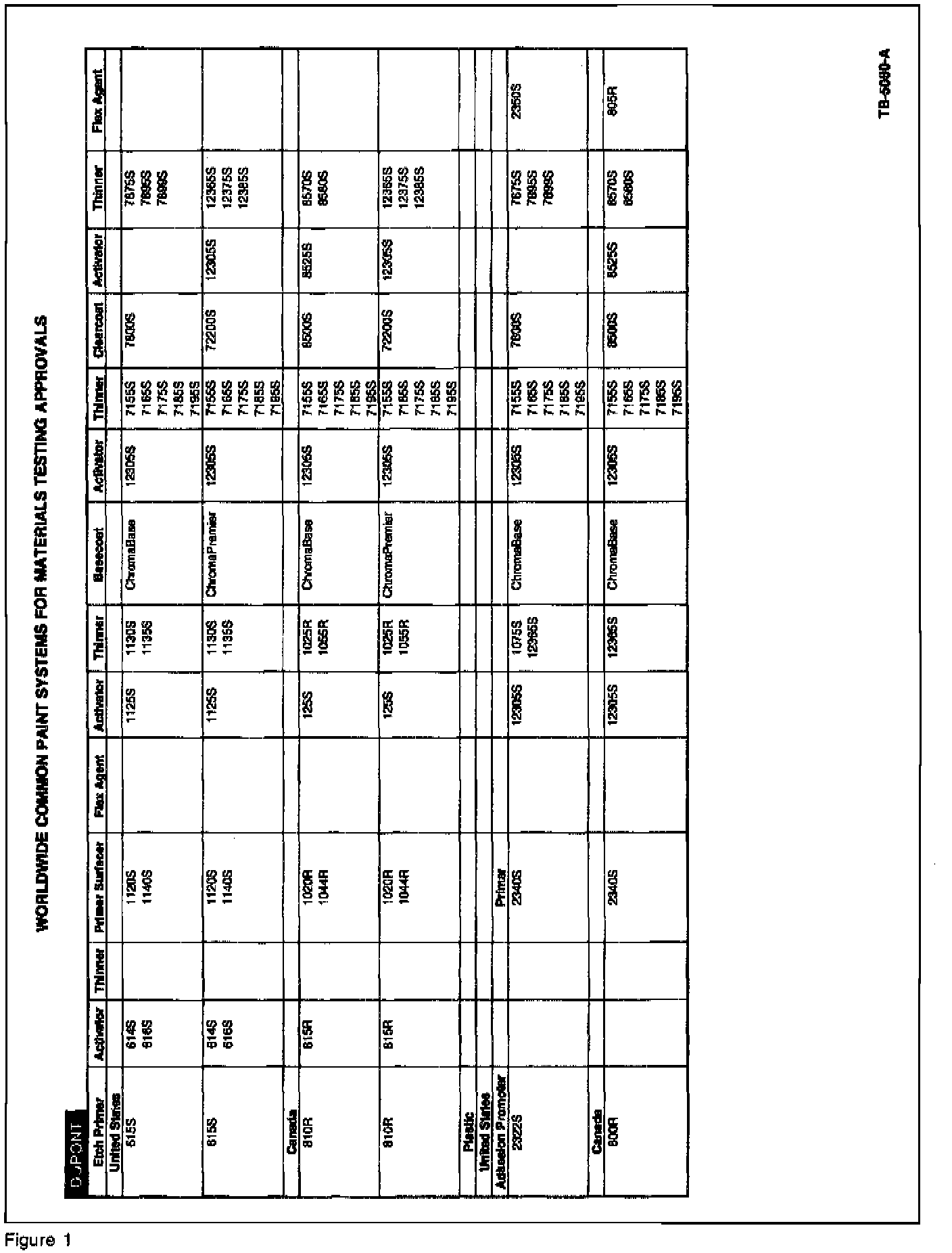

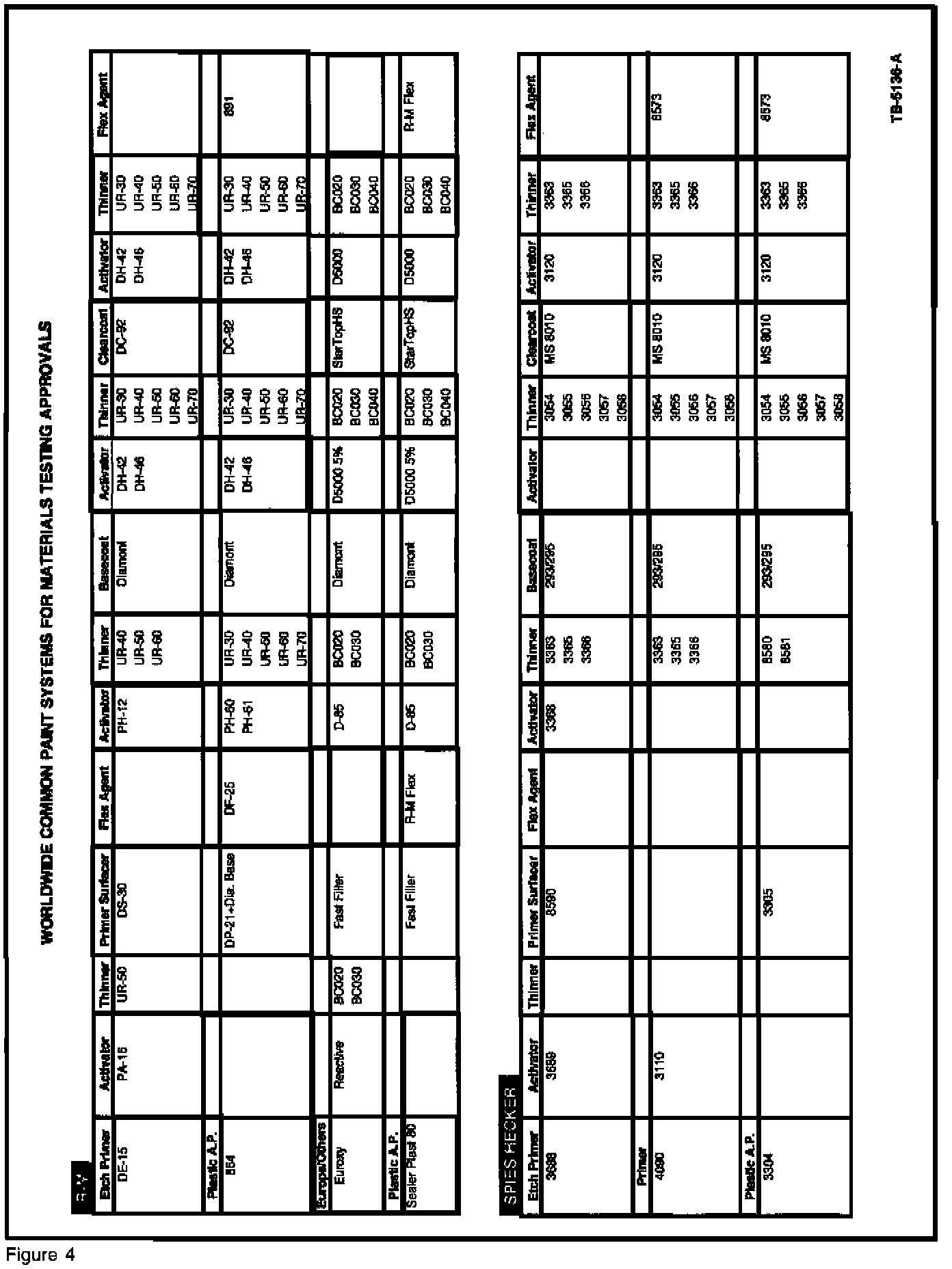

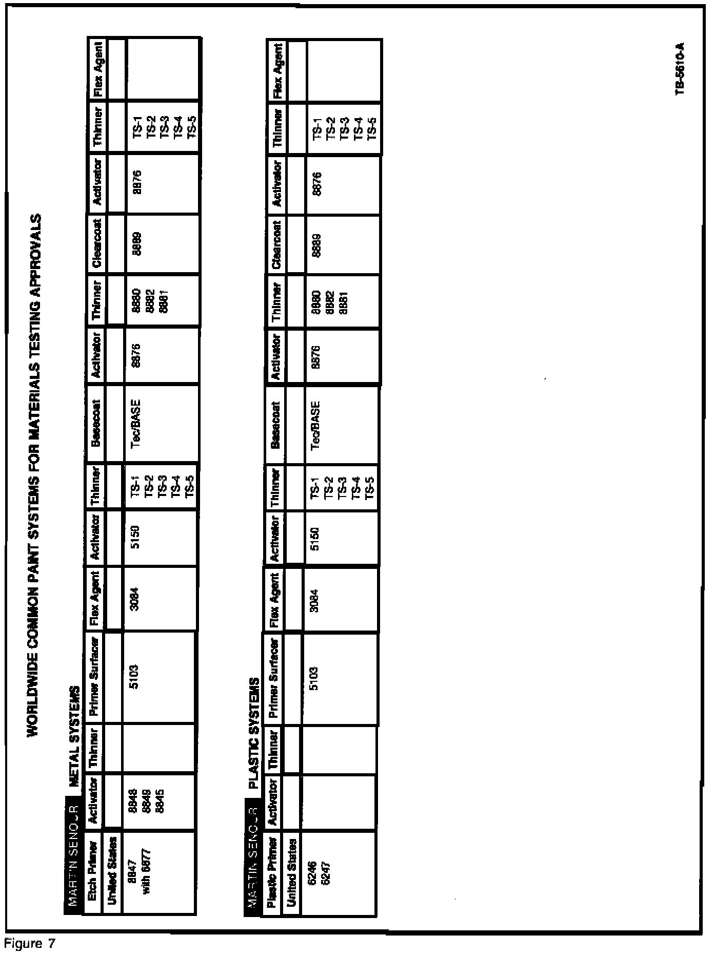

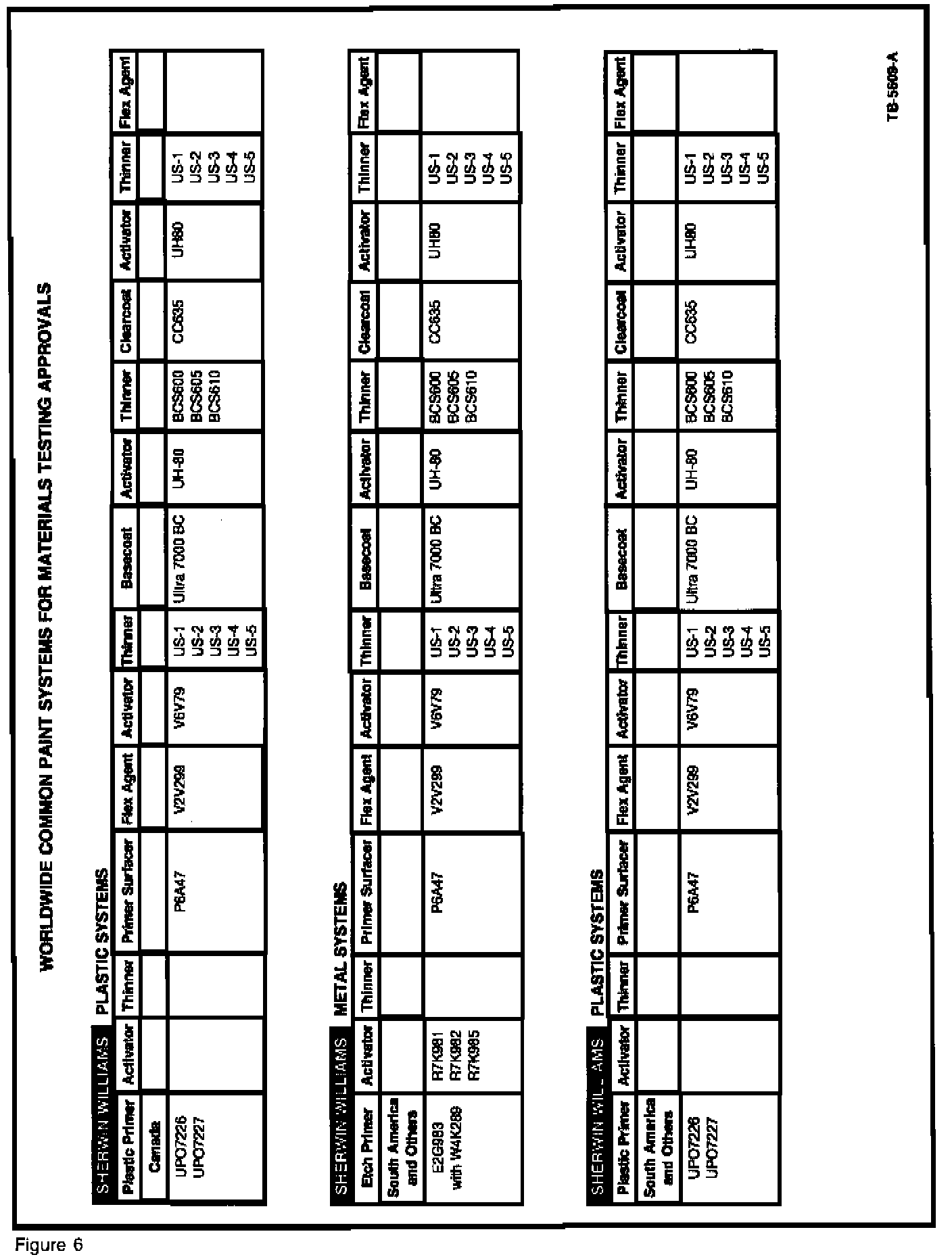

APPROVED SUPPLIERS AND MATERIALS

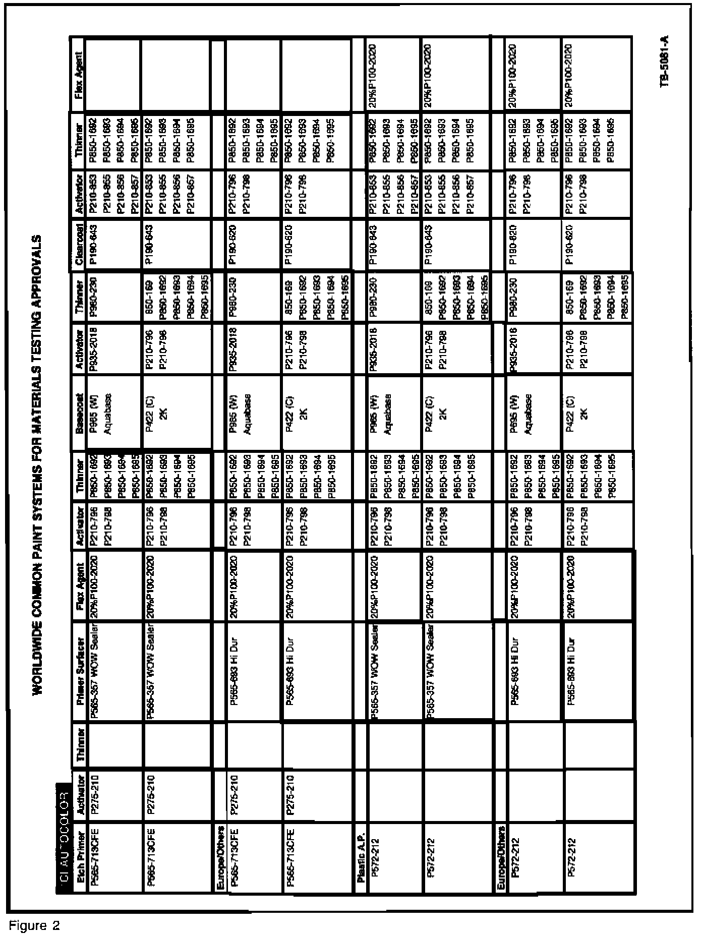

The Charts following this article (Figures 1-7) indicate paint suppliers and materials. Dealers should begin to use the recommended paint materials as soon as practical. Dealers without a body shop should provide a copy of this bulletin to the independent body shop performing their warranty repairs. The products listed in this bulletin may be made mandatory sometime in the future. As a result, dealers that have jobber/paint company contractual agreements should only contract with recommended suppliers (when existing contracts expire)
