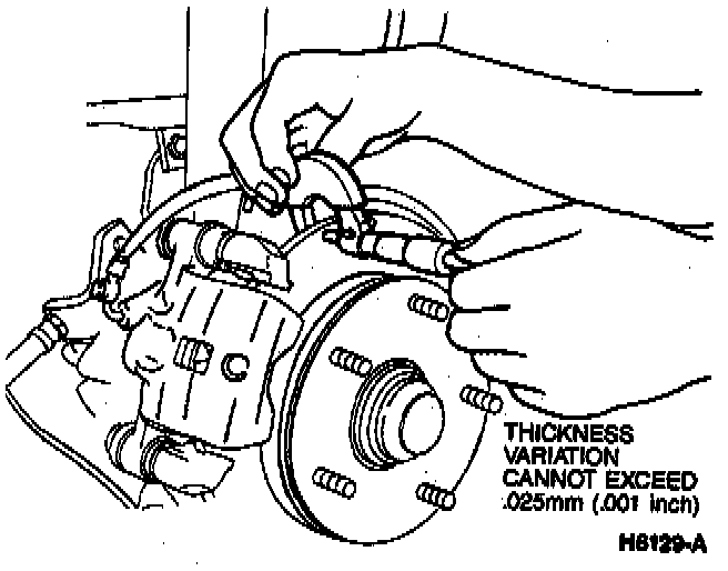

Rear Disc Brake Parallelism Check:
6. Check for disc brake rotor parallelism or thickness variation. The minimum thickness is 8 mm (0.315 inch). Disc brake rotor thickness must not vary more than 0.025mm (0.001 inch).
