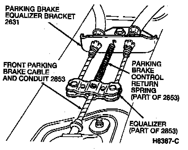

1. Remove the parking brake control.
2. From underneath the vehicle, disconnect the parking brake control return spring from the equalizer.
3. Remove the front parking brake cable and conduit from the tunnel access plate.
