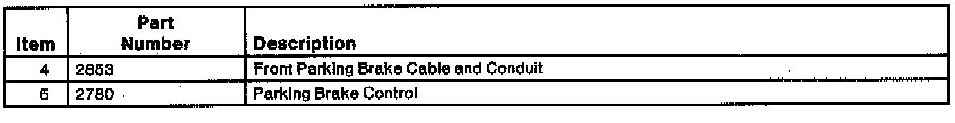

Parking Brake System Components (Part 1 Of 2):
Parking Brake System Components (Part 2 Of 2):
