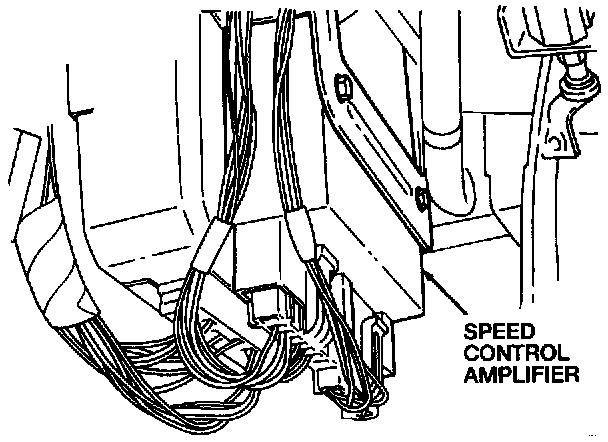

The speed control amplifier is located under the LH side of the instrument panel.
REMOVAL
CAUTION: Electronic modules are sensitive to static electrical charges. If exposed to these charges, damage may result.
2. Remove the two speed control amplifier nuts.
3. Disconnect the two speed control amplifier electrical connectors and remove the speed control amplifier.
